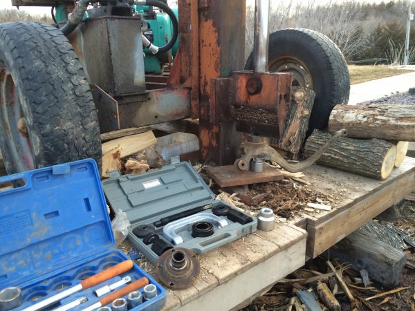

    Can anyone tell what I've got going here?
  2. Eric VW
    24,398
    140,394
    Pressing a bearing?!

    Good thinking.
    wildwest, Eric VW and HDRock like this.
  4. Eric VW
    24,398
    140,394
    Steering knuckle? for lack of a better term...

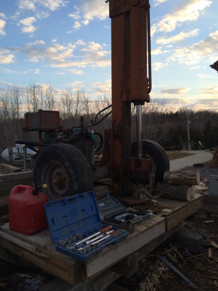

    Pressing a wheel bearing (out and then back in of course) on the rear suspension of an old audi a4. Earlier this winter when I did the other side I was looking around the shop trying to figure how I was going to get the dumb thing r&r'd. I walked out the door on the way to the house for the night and there stood a giant hydraulic press disguised as a wood splitter. And the rest is history.

    This one has well over 300k miles on it so I'm going to try and get by with just putting the camber adjustment bolts back in the exact same spots. I marked the heads before I removed them. If it doesn't feel right or starts to wear the tires oddly I'll get it aligned.
