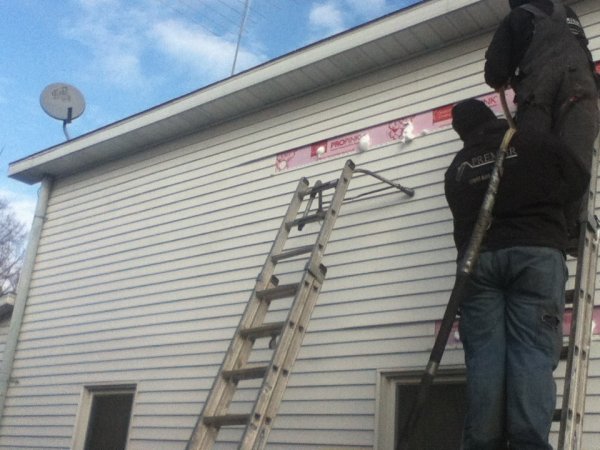

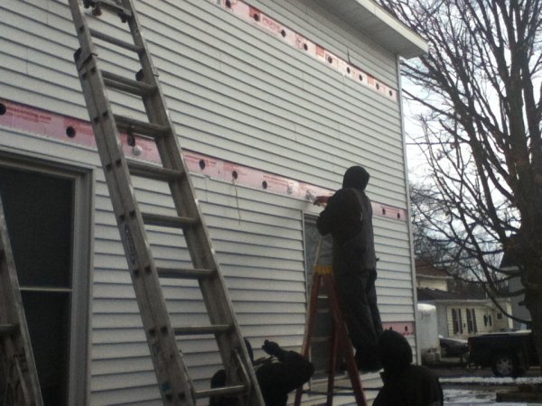

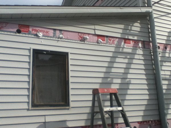

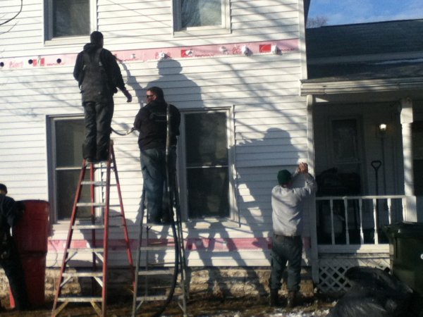

    Ok sorry for taking so long its been a very busy weekend. We used Tripolymer Foam http://tripolymer.com.
    Here are some pics for you! The benefits are just amazing first it does not settle over time like spray in cellulose. There is a down side to this however it is possible for panels to pop out however we did not have any issue with that at all.
    Secondly the foam is a noise barrier like I have never experienced in any other home. It cut out outside noises by a good 85% which for us is a big deal due to being next to a truck company.
    Third we have had tremendous difference in cooling! We used to run 3 air conditioners due to how hot the house would get. Now we can run one 8000 btu AC unit and it cools the entire 1000 sq ft downstairs with ease.
    Heating is something I have not words to explain but Ill try. We used to go through 6 cord or close to heat for a winter prior to the insulation. Since the insulation we use around 3 to 3.5 cord in essence doubling our wood supply. We run the stove at half in the dead of winter and a quarter this time of year and it just cooks us out. Our house is laid out fairly square however the bathroom is way in the back and is COLD when the furnace runs but since the insulation it stays about 15F warmer with the furnace and even with the rest of the house with the wood stove. Our biggest improvement is the windows! They used to frost bad in the winter that too has stopped and due to the foam literally filling every crack we can't feel any draft at all anymore. O yes before I forget we went from no insulation to R24 insulation. The cellulose would have been around R19 in comparison. Still very good improvement either way.
    The foam itself similar to a foam cup in appearance and extremely light. It is designed to allow you to push wires through with ease. Overall we couldn't be happier. Dennis ( Backwoods Savage ) used the same company and has very similar results as ours. You may want to pm him for advice as well. There are many foams available and they are designed very close in comparison but do your homework and read reviews reviews reviews for your area. Personally I use Angies list religiously and have not had a bad contractor yet due to there requirements to advertise with Angies list http://www.angieslist.com. Any questions don't hesitate to ask!

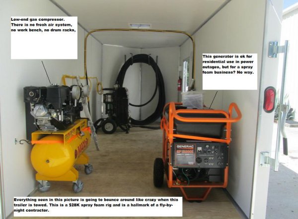

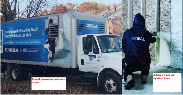

    The situation you are describing is called the stack effect; warm air leaks out of the upper levels of the house inlcuding into the attic and draws cold air in. Spray foam will knock that out in a flash. In terms of where to start, the attic is #1. Spray foam will seal every crack, pipe penetration etc and provide an impermeable barrier. Closed cell foam is the only way to go. Relative to contractors, there are quality spray foam outfits and countless examples of "Chuck in a Truck". Here's a quality outfit:
    Here's Chuck in a Truck:
    You can pick up a schlock outfit with some simple questions:
    --Do you have a panel truck or a trailer?
    -What model proportioner do you have? (A Graco E-20 is very low end). Look for an E-30, an H-25, H-40 or H-50
    -Do you have an on-board generator or do you use shore power? (Shore power means they will hook up to your electric dryer outlet or right into the electrical panel)
    -If you have a generator, is it gas or diesel? (If it's gas, disqualify them right then and there)
    -Is your compressor electric screw or gas? (If it's gas, disqualify them)
    - Describe your fresh-air system; you you have an Allegro system or respirator with cartridges? Cartridges=schlock
    -Will you scarf the studs when done or is that up to me?
    Gas generators and compressors are a hallmark of low-end contractors. They do not last nearly as long as diesel generators and electric screw compressors, produce unbearable noise inside a trailer and are fire hazards. Plural component foam is very flammable and having a gas engine in close proximity to 55-gallon drums is asking for trouble. If they have a diesel generator, it will usually be contained in a mini-room at the front of the trailer or box truck which is much safer. As for pricing, expect to pay from $1.00 to $1.50 per board-foot. Chuck will often take a bid from a quality contractor and then underbid it to get the job. What out for Chucks because they sucks.
