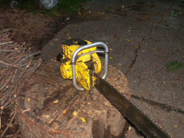

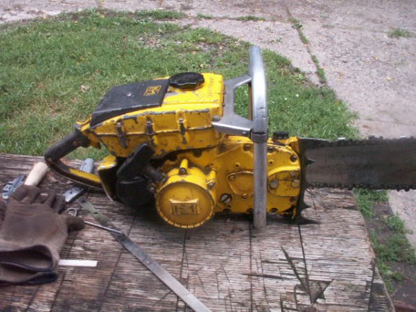

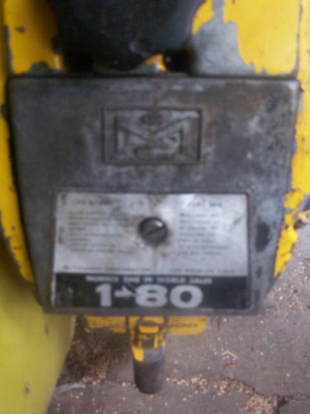

    My 1-80 gear drive,87cc/5.3 cubic inch,with 32" bar & very rare Oregon 5A 9/16 pitch chain.Model was produced from June 1959 to July 1960.Features one of their early racing cart engines - the MC-10 with removeable cylinder head & head gasket.Will pull 42" bar/chain buried all day long

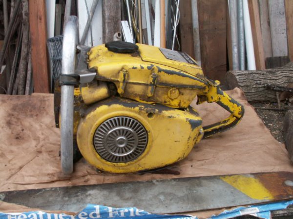

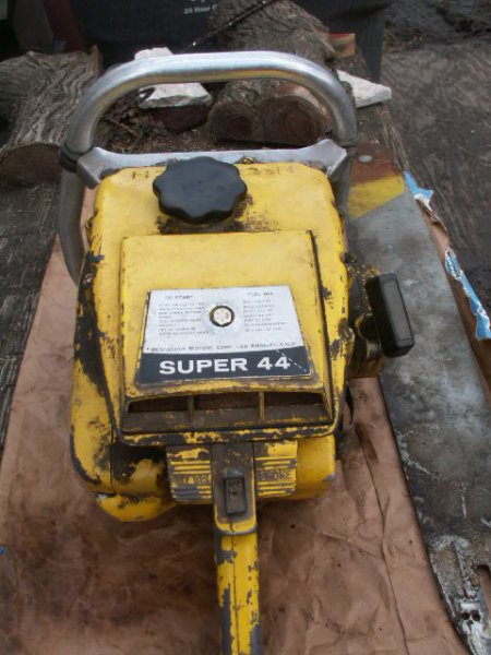

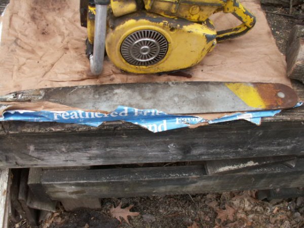

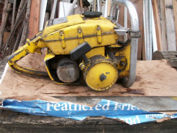

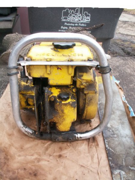

    Arrived today.Good compression/spark,all parts present/unbroken.Manual oiler is like a geyser,couple pumps & its right out there.Needs fuel line & minor carb work,a good cleaning.
    All in all pretty good shape for the vintage.I'll get started on it hopefully in a few weeks.
