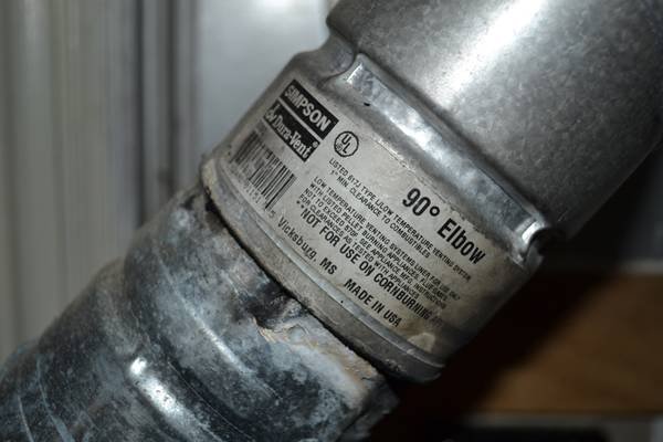

    Ummm.
    Ummm.
    Yep. At a loss for words.

    Looks like the 90º isn't connected properly, Going by the pic's. :confused:
    Don't know the clearance on the PDVC, But isn't that too close to the wall? Also looks like they vented it out the window. o_O
    343amc and slvrblkk like this.

    I think they broke every rule in the book with that install , lucky they have a house to sell .

    The floor protector is a very nice touch.......to me, it looks like the hopper lid might have had burnback at some point too.

    That type of "install" the clearance is 4" to the wall. That really is crazy...

    If its six years old it should be auto ignite. Install seems legit. :eek:

    Something might auto ignite with that setup. I'm just not sure it would be pellets inside the burn pot.

    My gut feeling is they hastily installed it to get a pic of it running and that was not its regular permanent location.

    I went on a Santa Fe service call like that 3 months ago. Pretty much an identical install but the stove was pretty much in a SUPER CLUTTERED DUNGEON and I'm not joking. A 3-4 tee on the back, and about 12' at around a 30 degree angle, then a 90 through a BASEMENT window, through the floor of a greenhouse (under the floor) and had a plastic DRYER vent for a cap on the outside.
    At least this Darwinism victim has an OAK lol
