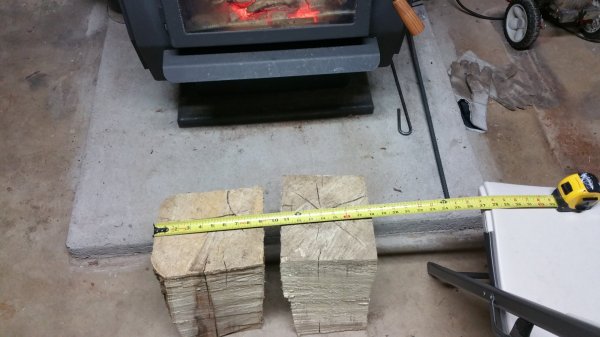

    So i cut two BIG hunks of Hackberry with the saw in the end of november. They each just barely fit through the loading door on a BK princess. When i cut them i probed them with the MM(Moisture Meter). For my experiment im going to track the weight about once a month unitl i burn them, i plan on burning them once the weight change flattens out. I have been storing them about 4 ' to the side of the stove along the block wall, which is also where I keep the stash near the stove, about a face cord at a time. So here is my math for one of these pieces, let me know if im on the right track. Also, i realize ALL of the math below
    is assuming that my MM gave an accurate reading intially.

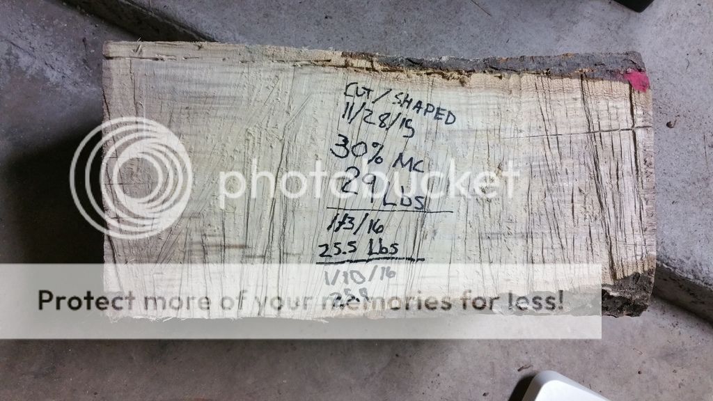

    MATH EDITED 1/3/16 4:23PM EST
    Nov. 28, 2015
    Weight - 29LB
    %MC - 30% per MM
    29lb / 130 = .2230 Pts of total
    100%(wood value) * .2230 Pts = 22.3Lbs wood
    Jan. 3, 2016
    Weight 25.5 LB
    3.5lbs water lost *.2230Pts % = 15.69%pts lost
    30% MC original - 15.69% lost = 14.31% MC left in wood.

    I guess i forgot to mention what makes it an experiment. I'm going to split one and recheck with the MM just before burning to see if my projected MC is close to what the MM tells me it is....

    You are on the right track but your calculations are a little wrong. The way you did it is on a wet basis. Moisture meters read on a dry basis. Dry basis is expressing the weight of the water compared to the weight of the wood if it had no water in it. Wet basis is a simple ratio as you worked it out to be.
    To think on a dry basis it is much easier to understand if you think in terms of parts and not pct. You will always have 100 parts of wood and the moisture meter reads the number of parts water that there is. So 30% you have 30 parts water and 100 parts wood. Or 130 parts total. So divide your original weight 29 lb by 130 to figure out what a single part (or pct point is). 29 lb/130=.223 lb. Round it up to .25, each point of moisture is going to roughly weigh a quarter pound.
    The wood itself with no water weighs 100 x .223 or 22.3 pounds. That never changes and will be a light as you can make it providing your original reading was correct.
    So your loss so far, 3.5 pounds will amount to 3.5/.223 = 15.69 points. (The actual water loss is in fact quite interesting). Your starting measurement was 30%, You are now at 30-15.7=14.3% or you have 100 parts wood and 14.3 parts water. And those calculations are all relying on the original measurement being accurate across the piece of wood.
    Make sense?

    Fyi, these pieces are what I plan on using for the time lapse video I've mentioned. I realized my action cam will die long before the stove quits so I'll have to borrow a camera from my SIL.

    Updated data from the weekend, calcs to follow

    Gained almost 1/2 lb on the 2nd, smaller piece, or am I seeing the numbers wrong?
  18. bobdog2o02
    bobdog2o02
    Nov 19, 2015
    3,005
    10,406
    Drury Lane, PA
    It's a 4. I know it looks like a 9, hard to wrote on the wood worth the saw grooves
    papadave likes this.
  19. papadave
    82,468
    Ok, so it still lost a little bit in the last week.
    Are they off the concrete floor? This is interesting stuff.

    Nope, sitting on the concrete 3ft from the dark box.
