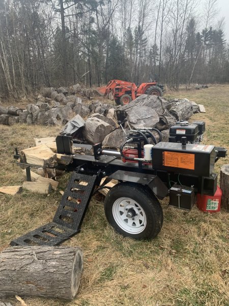

    Six hour use Honda flawless
    300 # sugar maple lifts no problem a lil tippy on uneven ground with narrow base.. duh
    Knotty yard tree splits no problem more than enough spliting power mostly 40% engine speed

    Wow! Those are some serious rounds!

    Why they were dropped for free.. should have finished them sooner my splitter died; life always gets in way but I will measure a big one

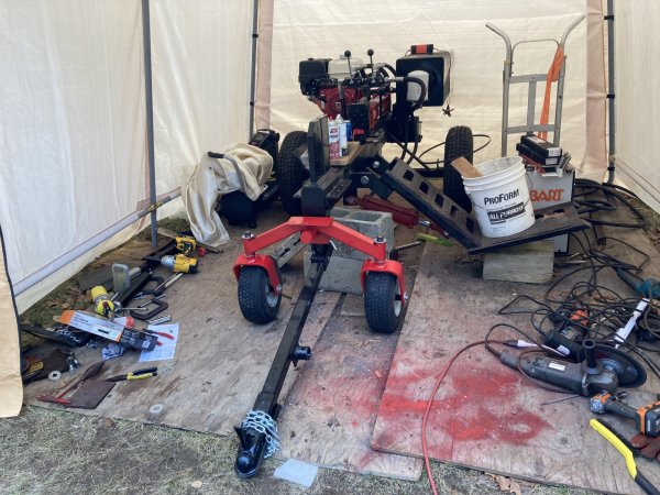

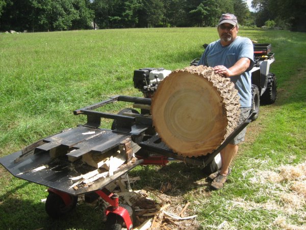

    It’s a quality built American machine in the beginners commercial category. Not overbuilt, not all the bells and whistles but it does what it was designed for.
    As expected I butchered mine up, added caster wheels, push and pull on both ends and a box wedge. The Super is NOT the machine for a box wedge as it’s designed for speed more than power. But if ya keep the gnarly stuff to a minimum it’ll do the job. Been having fun ever since.
