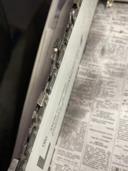

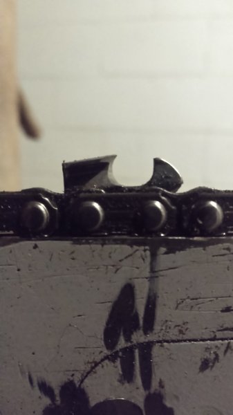

I'm no expert, I still am learning every time I file but from what I can see it looks okay, how's it cut? That's 2 different chains from The last time I filed

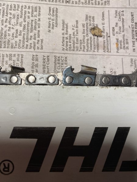

Looks good from the angle. I look at the edge from the front of the bar and if I don't see shiny, I call it good.

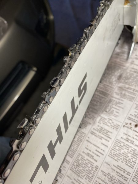

This pic looks like you’ve been in the rocks and need to file back more on the top plate to remove the damage

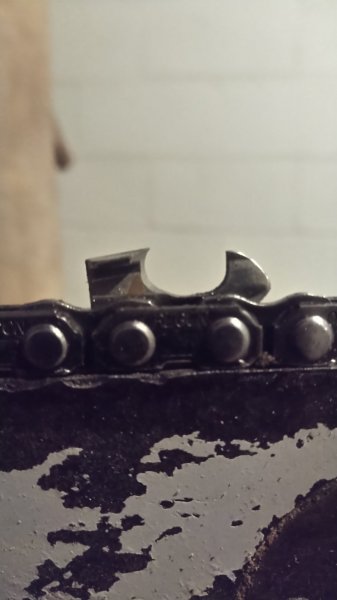

Both saws seem to cut very well the second picture of chain i had removed all chain lube so it made a clearer picture. Since just starting to use the Stihl 2 in 1 sharping tool, i am just trying to get as good of a sharping as i can and get as much life in cutting before needing a real shop machine sharping.
The gullet should be a little more evenly round. What size/pitch is the chain? How are you sharpening...ie free hand file, filing guide, dremel etc?
First question, how does it cut? From looking at this chain, which I can see clearer than the chain in the first pic, it looks like at least the first full tooth from bottom of pic needs a little more filed off to give it a full cutting edge. Other thing I noticed is that it looks like the gullet needs to be cleaned out some more. Each chain has a “recipe” for how it should be ground/filed. I grind for the most part, so I set my grinder for all of the appropriate angles and offset that the manufacturer recommends. If you wanna see a good video check out some of buckin billy rays stuff. He’s a pretty entertaining guy from canada and he loves to talk about “cleaning out the gullet” once you’ve mastered this, get in touch with The Wood Wolverine for mastering the square file technique!
