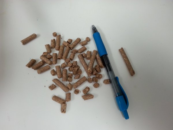

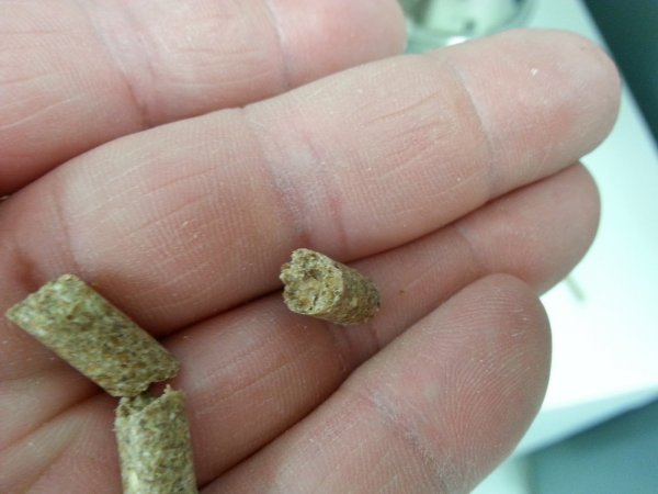

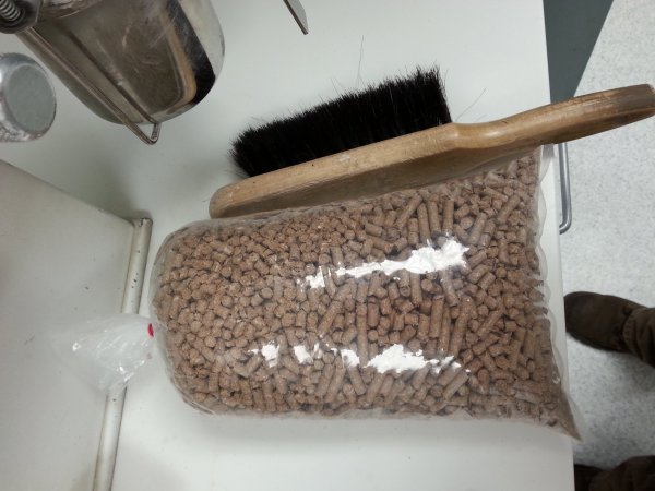

    I can get these where I work for $80 per ton. What prices have you found for alternative fuel? 20160610_084456.jpg 20160610_084113.jpg 20160610_084415.jpg

    Looks like some short and some longer than average Pellets.
    I'm sure Jay, myself, or others would be willing to test a bag for ya? Just to compare the heat output to other Pellets?
    It's warm here, but I can quarantine my pellet furnace heat to the basement. :)

    Im curious about the density of those wheat mid pellets, and wondering what effect that might have on feed rate versus btu output (thinking Harman here)....Ive seen Harmans burn alfalfa pellets, switchgrass pellets, dried peas, Acai pits, corn, etc.
