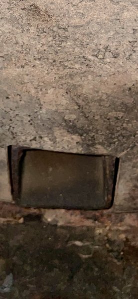

Aladdin Quadrafire classic Bay fire box center baffle warped around pellet drop chute
Discussion in 'Pellet Stoves, Pellet Fireplaces, Pellet Furnaces' started by don2222, May 8, 2023.
  1. don2222
    don2222
    Nov 10, 2013
    3,341
    4,625
    Salem NH
    Hello
    Has anyone seen this?

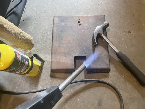

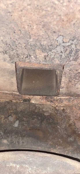

    I got a bottle of Map Gas and my hammer and just started heating and beating! It worked! Before you could Not see the edges of the pellet drop chute. But now you can! Now it looks like it should!! $10 fix !!
    Map Gas from ACE hardware for 5300 Deg F
    Ace MAP Pro 14.1 oz Gas Cylinder Steel 1 pc - Ace Hardware
