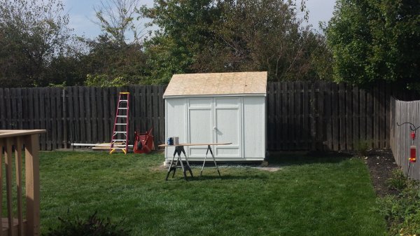

    Just knocked out 2 coats on this 8x10 shed in 1hr including back brushing once. That includes setup and cleanup too.
    Everyone needs a paint sprayer.
