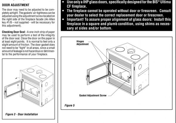

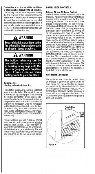

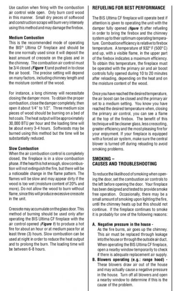

    I have a BIS ultima Stove , I put a thermometer on the black pipe above the fire box, I dont run it too hard but I am seeing temps at that point of 550-600. I was told its too high but if you read the manual they don't say anything about safe operation temps.
