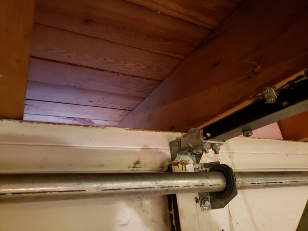

    My apologies in advance if the title is the incorrect terminology. Any-who my oldest daughters bedroom is directly above the garage, its cold! Sometimes very cold and I understand it probably will never be like some of the other rooms that aren't over the garage.
    However I wanted to take a stab at improving it a bit so I pulled back the drywall on the ceiling at the front of the garage in an attempt to block off or seals the rim joists. Initially I thought her bedroom ended right around where the garage doors are located. However I quickly learned that her room actually extends out past the garage doors about a good 18" 24" so my rim seal idea became pointless. In fact her bedroom HVAC vent is actually going outside past the garage doors and then up into her flooring. There is existing two sided faced fiberglass insulation laying between the joists.
    So back to square 1 and seeking advice on the best and perhaps a cost effective way to stop that air flow and block that off. I have on hand about four 2" foam boards my brother in law gave me. One of my ideas was to rip down those foam boards to fit in between the floor joists flush with the bottom of her bedroom flooring and spray foaming around the edges to seal it in. Would that be a decent solution?
    If I added some insulation as well below the foam board would that cause some type of moisture issue?
    My other more expensive idea but might be easiest and most efficient was buying a spray foam kit and just spraying the bottom of the floors to break that barrier. Thanks in advance for your time and help!

    Can you get any more pictures? I'm curious where her room extends over the garage if it's just covered with soffit or ?

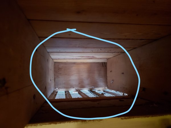

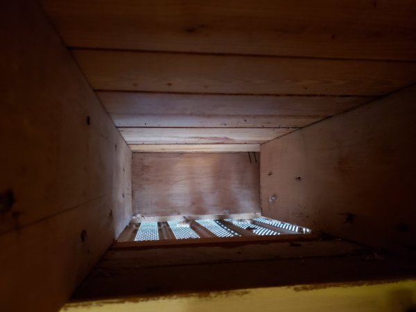

    You can see the end of her room in this pic
    That's a very good idea and makes a ton of sense. A bit out of my league of know how and while it wouldn't be a terrible place to have it if got moved into the interior part of the room it would be more in the way of where you walk a bit. Room would have to be re-arranged a bit for sure as currently its close to the wall.

    I see the "soffit" is vented...where does that joist bay go (the other end) anywhere that it needs to be vented?

    Thanks brenndatomu ! So the other end of that joist bay go back towards into my garage and into my house. I'd assume it would hit another cross beam at some point. The complete Opposite end of it would be the back of my house, there is no soffit over hang out back there. Sorry hope that makes sense, I probably butchered explaining it.

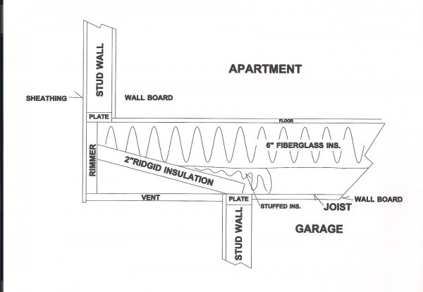

    Assuming that I understand your situation correctly, this could be a way to insulate the apartment overhang and limit air infiltration into the garage. This will also maintain a modicum of air circulation above the soffit. Caulk or spray foam as needed. Just a thought! overhangdetail.jpg

    This is exactly what I looking or thinking of doing! My next question to the forum was should the foam board go first below the bedroom flooring OR should I put the fiberglass insulation 1st and foam board below? I am thinking the foam board 1st and fiberglass or roxul insulation below that would be easiest BUT easy isn't always right. I think either or would work but what the hec do I know :whistle:

    Probably either would work. You can only split hairs so fine. My thoughts on doing it this way is that you maintain a vapor barrier to the outside air, give support for the fiberglass insulation to keep it from drooping into the ventilated soffit and provide a ridged seal to stop air sneaking into the garage joists. Theory does not always work out exactly in practice. I would think that anything you do would be an improvement!

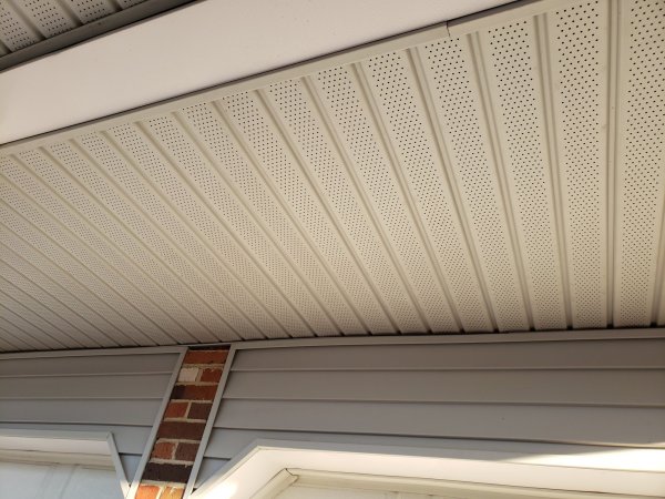

    I understand the basic principles and am no expert but I am not sure why its vented either. And a little shocked that the room even extends out over the front of the home like that (even though you cannot tell it by the photo) and then the soffit is vented, makes little sense (again am not an expert or builder). It was stuffed with insulation anyways, so why not seal it off! Also shocked that the hvac vent goes out into the soffit as well. With soffit vented like that I wonder how warm the air coming out of her vent even is. This room is doomed to be cold! I took an outside pic to give a better idea.

    This is the tie of year for builder shows around here; maybe in NJ also. Point I'm trying to make is seek out a spray foam installer/company and have them spray some closed cell into all of those joist spaces that are cantilevered out past the garage door wall.
    As far as the vented soffit goes for that area, maybe the builders just wanted to keep things consistent. I see the eave is also vented soffit but again, don't see where that air is vented out for circulation.
