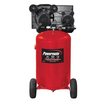

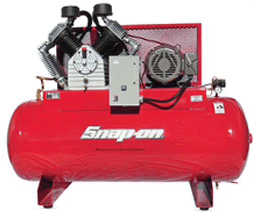

    Craig there are a lot of brands out there and most are good. First thing to know is there is electric diaphragm pumps and electric motors that drive a separate piston style pump. The piston style are far better in my opinion having run both. Diaphragm will be very loud and not pump as fast where the piston pump will really put out air and be much better on your ears. Just ask my neighbors lol they no longer complain with out piston pump.
    Above is the diaphragm compressor below is a piston pump.
    At home I use a 30 gallon coleman compressor that runs nailers, all sorts of auto air tools like air hammers, chisels, ratchets, impact drills, hvlp spray guns and so on. That is very portable and moves with easy.
    Mine is an older version of this style.
    If your going to run an impact you will want a minimum of 20 gallon compressor weather horizontal or vertical and I can say with experience diaphragm though good will get old very fast when your using an impact because they use a lot of air fast.
