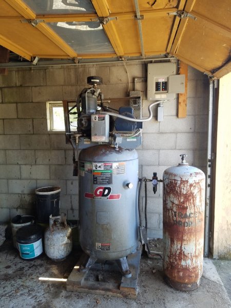

    20180430_140005.jpg $150.00 deals are there if you are patient. 23cfm@ 175psi. 80 gallon tank.

    Had 175 in repair shop I worked in. It's nice when you need it. We kept it regulated down to around 140 at the couplers.
    That looks to be a nice unit. Pull a fitting and shine a light down in tank to make sure there's no excess corrosion. Exploding air tanks are no joke!
    Looks like a 7-1/2 hp motor. Most likely continuous duty cycle. That's a good mark of a heavy duty compressor. Centrifugal unloader. I assume there is a smaller jug on the backside of the large one...two stage.

    Close, it's a 5 hp, tank looks like new inside. it is a 2 stage continuous duty, unloader and a cooler. I think that the cooler is a boon for tank life. When I drain the tank I get a few drops of water, nothing like my old one. My old 30 gal. I would get a cup or more.

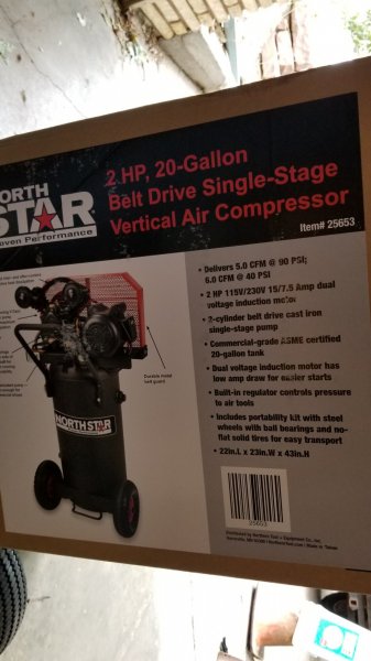

    Picked up from Northern Tool this weekend, with military discount 10% and on sale for $469. Picked up the start up kit, oil and filters, for a full 5 year warranty. Been looking awhile and these look better than most in this price range. Hope it holds up for the next 20-30 years.

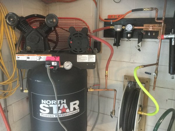

    FF25A6C1-4E93-4688-BA4D-3EA8BC751CB1.jpeg Installed a Northern Tool 3h.p. Compressor about a month ago . Couldn’t be happier with the service I recieved ,or the compressor .
