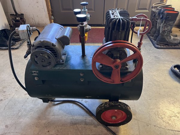

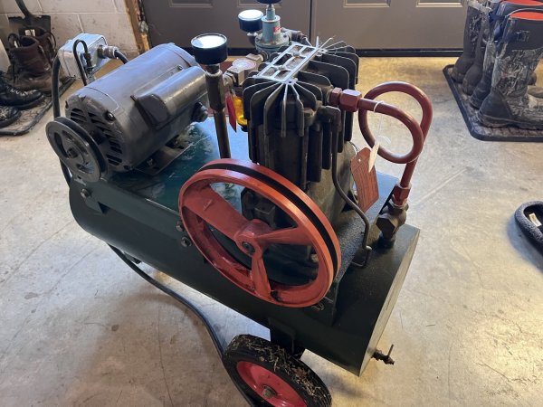

    When I was a kid my dad built the air compressor that's in the pictures below. He rolled the tank, fabricated "the deck" for the pump and motor, and paid an unemployed friend to weld it all together for him.
    It's been sitting in their garage for a while now and he wanted me to have it. Figured it would be good basement air compressor for the little projects I do in the winter. My dad had the compressor wired up for 24oV so he was able to wire up the motor so it ran per the arrows on the flywheel on the pump. I'm running it off of 120V and it runs the wrong way. The motor is supposedly a 120V reversible motor but I can't get it to run in reverse. I've flipped the plug wiring, changed the wiring in the motor and I can't get it to run in reverse. Was talking to a friend and we both agreed that it shouldn't matter if air is being pulled over the pump or being pushed over it. Are we way off in our thinking?
    If I measure on the outside of the flywheel on both the motor and pump it comes out to 55" long with the motor pulled all the way back towards the pump. Should I get a 56" long belt? My dad scavenged the 240V motor off the compressor at some point. He found / bought a new motor but it's a different speed so we had to change the pulley size as to make sure we didn't over speed the compressor pump.
    There's a pipe handle that goes on the front of the compressor but I broke it yesterday pulling it through the yard. :doh: Need to get that welded, and painted.

  2. Screwloose
    Screwloose
    Jan 15, 2017
    5,628
    33,265
    Swap leads #5 and #8
    Cooling is not the only problem. Some pumps have troughs and holes to collect splashed oil and some are angled to match rotation.

  3. morningwood
    morningwood
    Oct 17, 2022
    434
    2,082
    That was it. If you are ever near central Ohio, get ahold of me and I'll buy you a barley pop, pop (Coke for our friends in the south), water, or a coffee.
