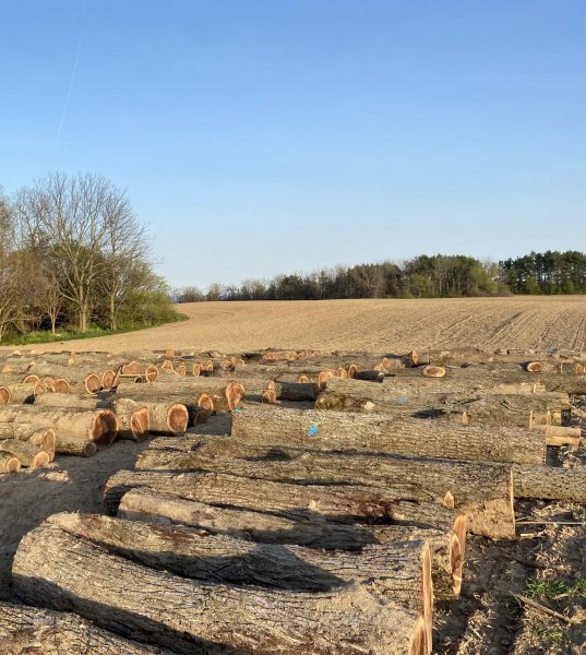

    Ok just to follow up. All got done the past two weeks. Took about 50 trees down, mostly walnut. I had $$$ in my eyes but when you see them on the ground you see there’s a lot of crooked ones and hollow ones. But also a lot of nice ones.
    Out of 200+ sawlogs had 6 veneer quality ones that were worth a lot. The rest did ok. And the forest doesn’t seem too worse for the wear. And my trails are nice and clear. I will use some of the money for a box blade to keep them that way.

    Pic #3 shows me a veneer log and I’ve sold a bunch over the years
    he holds his girth for a long way
    nice lot sir!

    Yeah that was the best of the bunch. Wish there were more like that one. It’s headed to Kentucky to a veneer mill.
