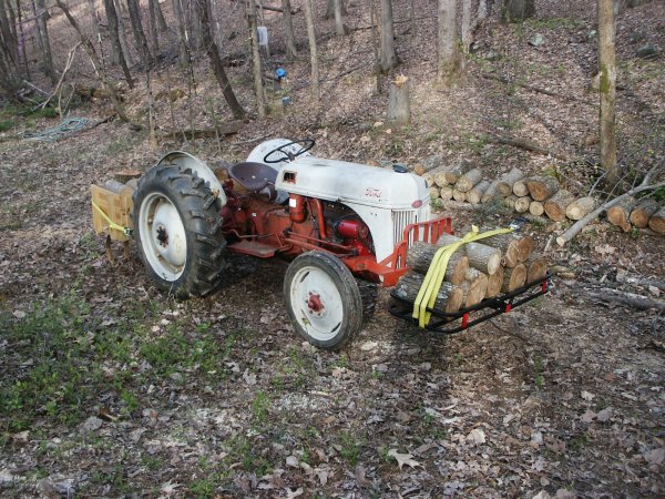

    The carrier I built works well but the load is behind the rear axle and the engine on an 8N is not that heavy; of course I have the same issue for the heavy disc harrow but most of the time the disc harrow is on the ground except from traveling to and from the gardens. The load made the front end light enough that it made me nervous and I don't have a roll-over bar for the 8N; something I would like to get. Harbor Freight put their steel carrier on offer so I broke down and spent the money to buy one. I was able to mount it to the front bumper of the Old Girl and load it and let it act as a counterweight to the load in the carrier. The plus is that I can also bring more wood out on each trip. What I really want to get is a small trailer to pull behind the tractor for hauling wood.

    Where the ball is I use a bolt and nut; drilled a new hole in the carrier, it slides into the bumper and then the nut and bolt.

    Nice work Kimberly. Those are good tractors indeed. Nothing like innovation and solving a problem yourself.:yes:
