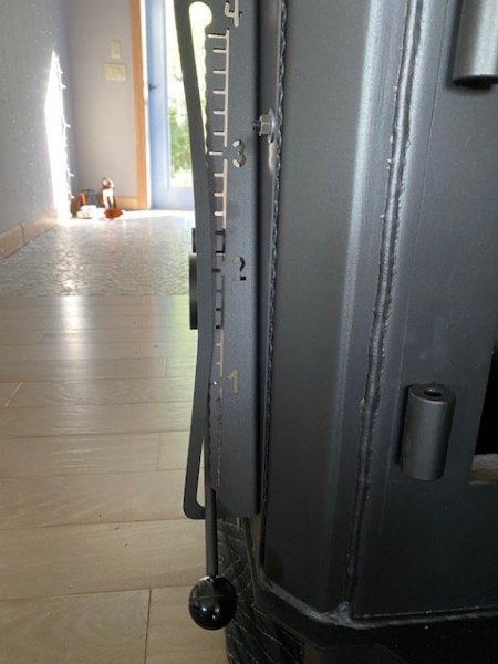

    My friend just had help bringing this in her house and the rail is bent. Stove was wrapped in shrink from factory. Is this part easily replaceable? I'm sure it can be bent back, I noticed the spline part near the numbers is not vertical and goes in towards the stove at the bottom. Is this normal or was that bent also...
    I'm not near where she lives and I'm just going by the picture. Absolute damage.jpg

    The part is just two bolts, but it is just mild steel so you can bend it back out and check with a speed square to make certain the flange is at 90 degrees to the back of the stove. That is very important.

    Probably bent in shipping. It would happen in a second, on the back of that stove.

    I hate to tell you, but that happened in shipping. We have a Drolet Blackcomb, built by SBI, in :canada:, that had the flange on top bent, ding on the top plate, and scratched paint...I guess I NEED 6 hands for thumbs up to that great quality, using your reasoning...
    I forgot, your COMMON SENSE has left the building, like Elvis...
    FYI...I contacted the company in Canada, they were great to work with, gave me a discount on the stove and sent me a free can of paint. I straightened the flange, fixed the ding and scrapes, repainted and been very happy since.

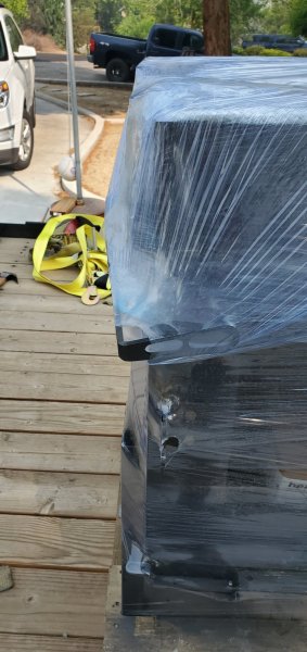

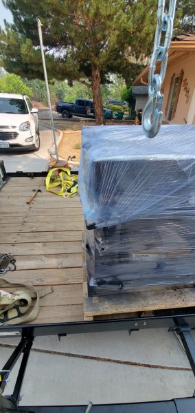

  17. NVhunter
    NVhunter
    Dec 28, 2013
    372
    1,963
    Northern Nevada
    Definitely from shipping. When my stove returned from Woodstock the cat engagement arm was bent in towards the body of the stove. I could see a cut or abrasion to the protective plastic wrapping on the arm where something in transit hit that area of my stove and caused the damage. We bent it back into its original shape and moved along.... No real damage and my damage was not worth b!tchin' about. I think the crates built around the stoves are less protective than when I originally bought the stove in my opinion... 20210724_101033.jpg 20210724_101026.jpg 20210817_190453.jpg
