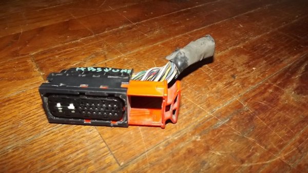

    I have a 1999 Toyota Tacoma in very good condition but have an ABS wiring problem and need advice!
    Just 130,000 miles on the clock so just broken in.
    A local one man shop did a diagnostic on the ABS module plug using the wrong equipment and damaged the plug.
    The Toyota Dealership which is a 3hr drive away says the entire ABS wiring harness has to be changed, for a charge of around $4,000.
    I have found a module plug on ebay. Is there any reason this plug with its pig tail could not be soldered connected to the original harness?
    Any advice would greatly be appreciated!

    Is the plastic connector damaged or just some of the terminals?
    I would assume the connector is if the dealer wanted to replace the entire harness.
    I would not have any problem with replacing the connector, but I would release each terminal and slide it into the new/used connector and only replace damaged terminals, versus soldering all those wires. my.02

    Why isn't the shop repairing what they damaged?
    I'd let him know either he can repair it or pay to have Toyota do it.
    Those plugs aren't easy to damage by just plugging something in. Didn't fit and he made it fit?
    But as far as DIY, I would certainly do like Smoke said. The terminal tools to pull those plugs apart are pretty cheap.

    Smoke is right,if the plastic is what he damaged(and a few terminals) easier to change the plug and repair a few terminals.Two things---1 most common abs problems on those trucks are failed front speed sensors and wires ripped off rear speed sensors 2--if he did something stupid and back probed the harness with a test light you may now need an abs computer.Have worked on yotas since mid 70's.Bob

    Thanks again for your input. Will know for sure next week when this second shop does a full diagnostic. Presently there is no communication with the ABS module.
