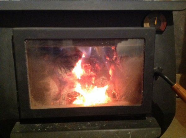

When running my BK at higher temps I have flames. My stove is running at about 550 right now at the stove top and there are flames in the stove. Air is around 40-45% (just under 2 on the BK)with a load of locust and mulberry. There are flames in the box but not near where they are in that video. Not a bad thing at all in my opinion just different stoves. I am curious though with other BK owners as to what flames they see. This is my first year with a cat stove so still learning. Pic for reference on the flames.
Swags, I'm thinking the wood will be more of a factor than anything. I get plenty of flame with the BKK wide open upon start with a fresh load, but I have to cut it back within 30 min. or I'll get the CAT to hot. I took the cover off the flapper housing and now adjust by sight, don't even pay attention to the dial. The stove goes dark quickly but the temps. rise. I normally get a 475-500 stove top and the Cat Probe will be in the upper end of the active range. Flue will stay about 4-450. That's with dbl. wall and a probe. Those temps. are with the fans going on High, so I'd read higher if they were off. I never shut the fans of.
