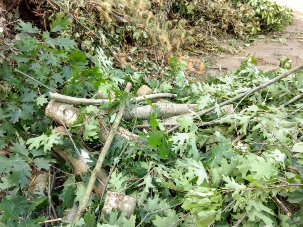

    I got to the dump just as a landscaper dumped this oak... IMG_20170817_1854.jpg IMG_20170817_28343.jpg

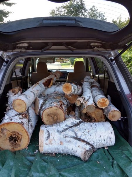

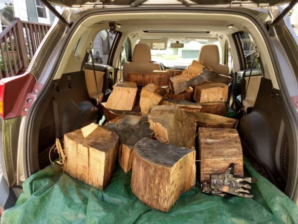

    Then the main course was a large birch, $30 for the whole thing. I got this much in the car ( with the homeowners help, a burly Russian), and will go back Sunday for the rest. IMG_20170817_5561.jpg IMG_20170817_13718.jpg

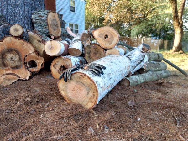

    I've got a chainsawing question, how would I go about cutting a log this big with my new Stihl MS 180? Or shouldn't I even try? IMG_20170817_21113.jpg

    I would cut from both sides of the log and roll it to finish up the cut.

    That's getting after it. Nice scrounge. Eric B has the answer. Make multiple cuts before rolling.

    You'll now want to get yourself some hard plastic felling wedges. They can get used to keep the log from closing and pinching your new saw bar. Plastic because they can fall onto your chain. Or, use a wedge of wood, nothing fancy needed.

    Also, I have cut several trees that were probably 5-6" wider than my 18" bar. Start at the top and cut down 4-6" then move the saw up to the top of the log and dig the bottom dogs (teeth) into the top of the log and then rotate the bar down through the back side of the log. Once thats done you can then start cutting through the near side and it will go right through. Or as said, keep rolling the log if its manageable. That will help keep the chain out of the dirt too!

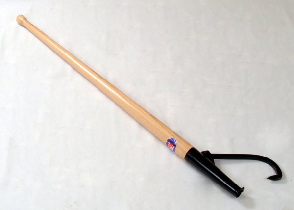

    For rolling, if you don't have a cant hook, this would be a great excuse to get one. A good hook properly applied will save many a rocked chain, imo.

    Dealing with logs you really should have a Cant Hook

    No need to cut from both sides. Instead of cutting straight down, place the powerhead on top of log and cut down the far side until bar tip almost hits the ground. Use the spikes in the front to lever the saw down. Then pull saw out and cut straight down the side nearest you like you normally would. This keeps you from cutting on both sides of the log, stepping back and forth, etc.
    Your 180 will cut that just fine, you just won't win any races doing so....but neither the log or your stove possess a stopwatch :)

    Midwinter yes, bocefus78 is right spot on with this and he was also correct with the video. That guy has the right idea but went too far with it. You saw, when you cut the side opposite you should never go beyond straight up and down as you really don't have any control once you go past that point.
    It will also help if you can take a small piece that you've cut to put under the log; not right under where you are cutting but close as this will keep you from pinching. As for the wedges, they can be handy but I've never used a wedge for cutting anything like that as it simply is not needed. Also, while cutting, keep an eye on the kerf and you will probably never pinch the saw.
    And one more thing you've been warned of; never let the chain touch the ground else you'll be sharpening that chain way too much.
