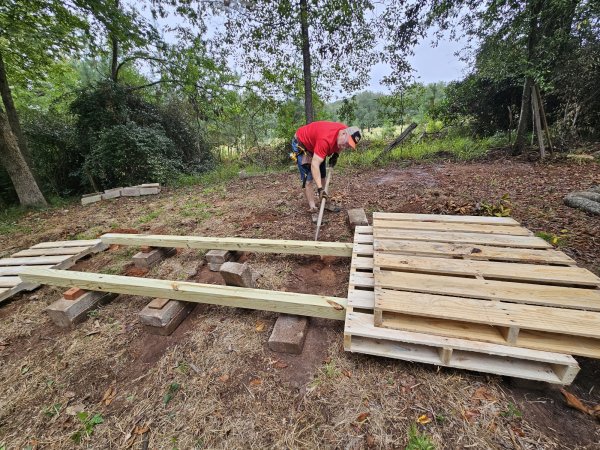

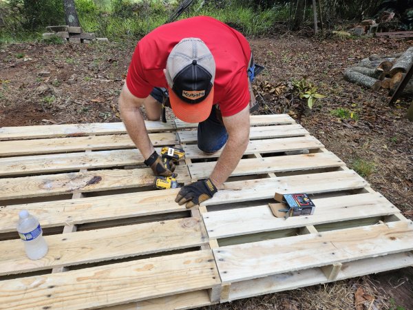

    End pallets are set where notch is flush with bottom edge... 20250929_110653.jpg
    Ends are now set...the floor is 2 44x52 and 1 36x52 pallets. Ends are 44x52 pallets.

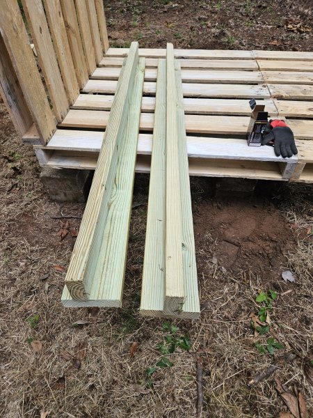

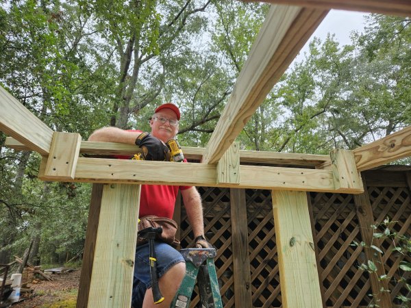

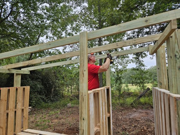

    Tried something new on this shed, we added a 2x4 to the 2x6 uprights. 20250929_113343.jpg

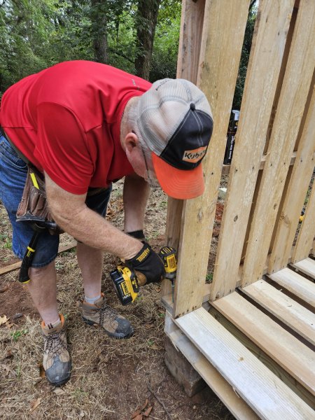

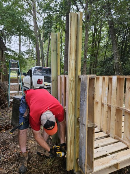

    The uprights are screwed into the 4x4's and both bottom and end pallets 20250929_113804.jpg
    She wanted a small section to store her kindling can and bucket. Added another pallet and upright supports 20250929_124423.jpg

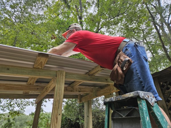

    She had several sheets of metal roofing that was 63" long, just did a good overlap and used 6 pieces to cover the roof... 20250929_142654.jpg

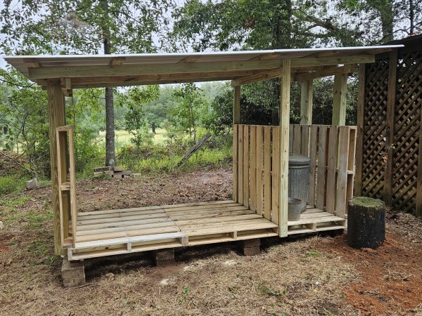

    We told her to get some diesel and ATF fluid and paint/spray bottom boards to help prevent rot.
    She had about $230 dollars in lumber and supplies. We had a 6' piece of 2x4 left over.

    I can't tell from the pictures, but what are the 2x4 on the uprights used for?
  9. T.Jeff Veal
    26,969
    168,778
    Strength/rigidity, we have built some for ourselves without the 2x4's, over time with a big load of wood, the 2x6's will bow out, since the weight is against the narrow side.

    Looks good. How do you get away with no diagonals from the roof to the walls or floor to the walls?

    When empty, it can be a little shaky sometimes, but loaded, it's very rigid. This shed is the sturdiest we've built. If needed, corner braces could go from roof to sides, at the floor would be in the way of stacking wood

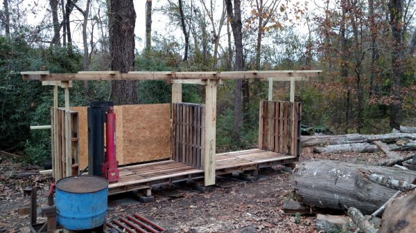

    These sheds we built are 10 yrs old now... IMG_20180616_175953.jpg IMG_20151203_162439323.jpg
    Bottom pallets are still in good shape, nothing was ever put on them.
    I suggested treating hers, because of the run-off from adjacent roof splashing on it.
