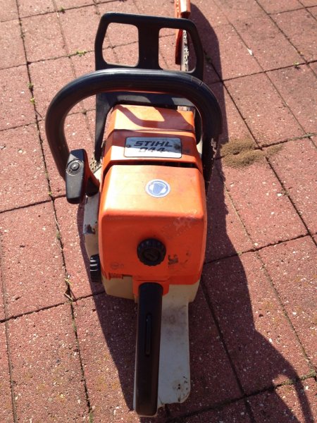

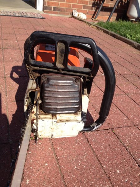

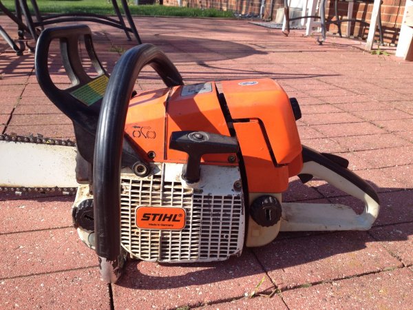

    Last year in April I got a pretty nice 044 with the 10mm wrist pin in trade. It was lightly scored, but 100% complete all the way down to a bar & chain. I got it from a guy I know who is a mechanic at a Stihl shop and they took it in on trade from the original purchaser. I believe the saw to be all original shy of a bar nut (one is not the flange type) and the pull handle (has elasto-start).
    I love these saws, so I wanted to do it up right. The cylinder cleaned up perfectly, and the bearings were tight and silky smooth, so no need to split the case. I gathered up a laundry list of brand new OEM parts for it that included a piston kit, wrist pin needle cage, base gasket, oil seals, clutch drum needle cage, rim sprocket, impulse hose and fuel hose. After getting all the parts it sat in a tote on the shelf for the better part of a year being a low priority project. I planned to keep it, and flippers/repairs always take priority over anything for myself. This week I found myself sitting on several projects all waiting for parts to come in, so it was finally time to build this fella.

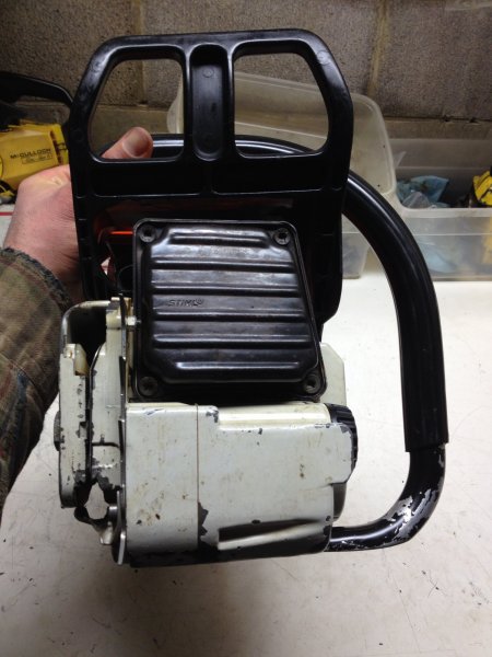

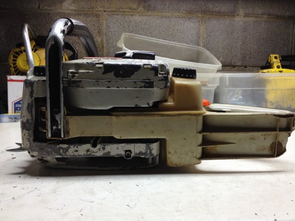

    Here are some pics as I received it, no cleaning or anything - just after picking it up:

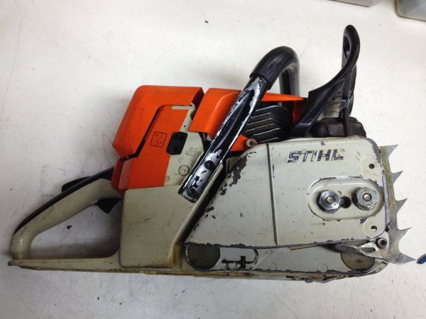

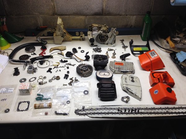

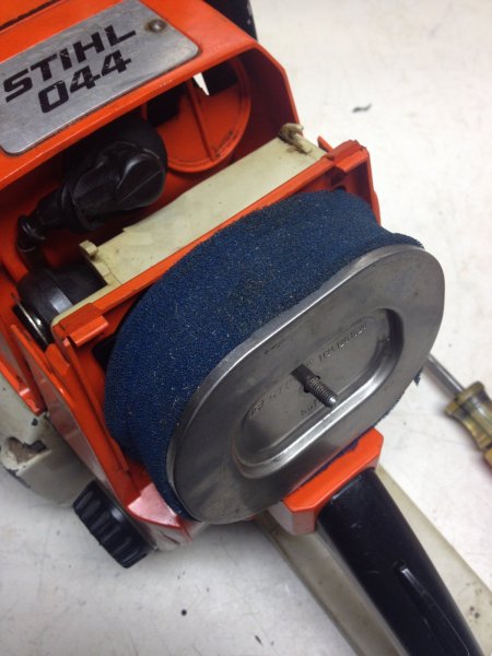

    Here it was after I was fully prepared to begin the rebuild.

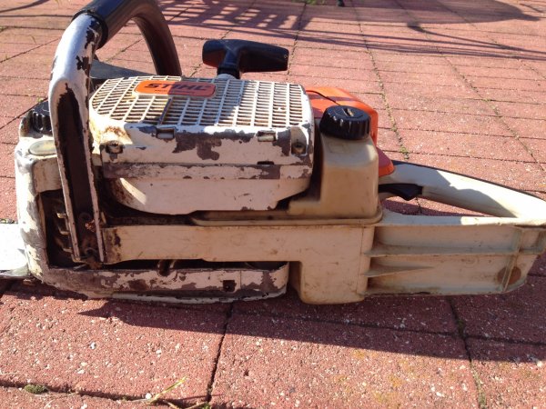

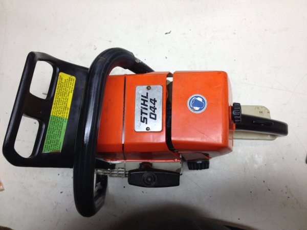

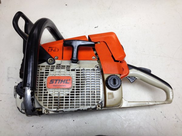

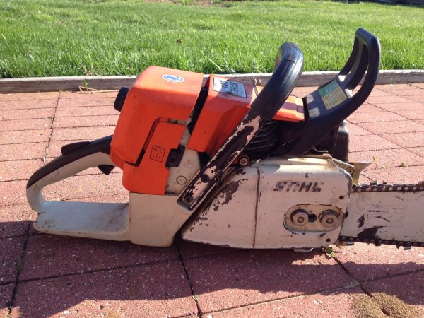

    And here are some shots of the final product.
  4. NewToStihl
    NewToStihl
    Apr 27, 2014
    807
    2,397
    Central Indiana
    While I was assembling it I realized I didn't have a carb kit, which I had intended to get, but I finished it up anyway. After getting it put back together I pressure tested the fuel tank & line, and then vacuum tested the tank vent. Then I vacuum & pressure tested the engine. All systems go, so I fired it up. It would pop and start, but then quickly die. Just for the hell of it I pulled the carb and cleaned it, but the diaphragm looked rough. I put it back together and it would run, but not quite right. I put it back on the shelf and ordered the kit, so now I wait again...

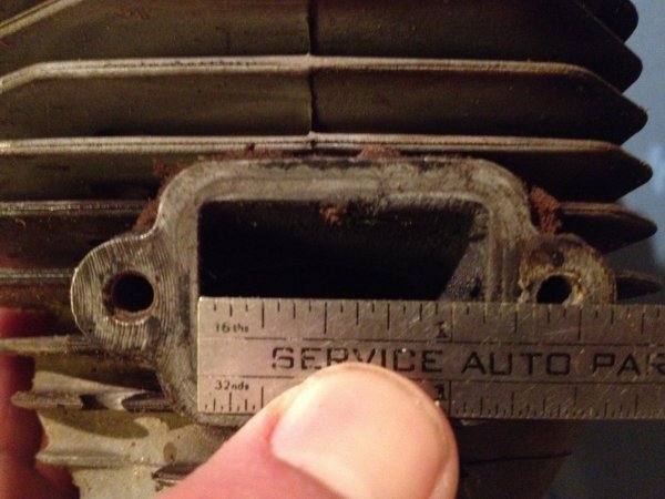

    Can you get a picture of the exhaust opening ?

    Sure, but it'll be next week before I'll be able to get back out in the shop. Just a photo, or would you like some dimensions too?

    A photo would be just fine ........ but a few photos from different angles and distances would be pure perfection.

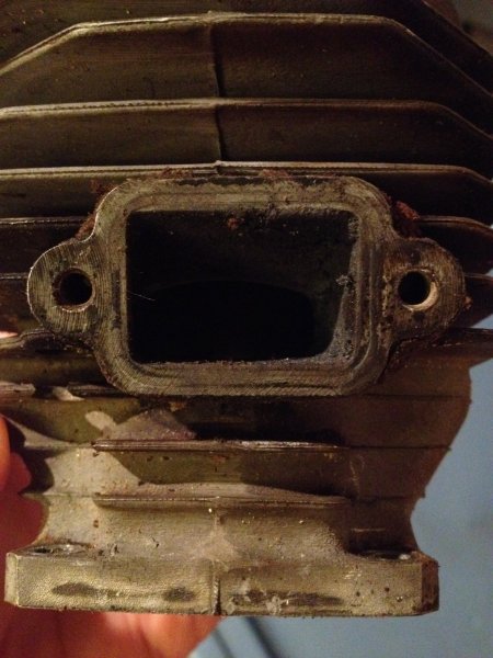

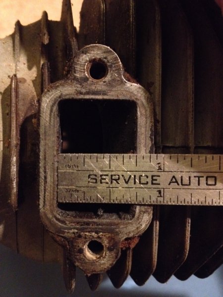

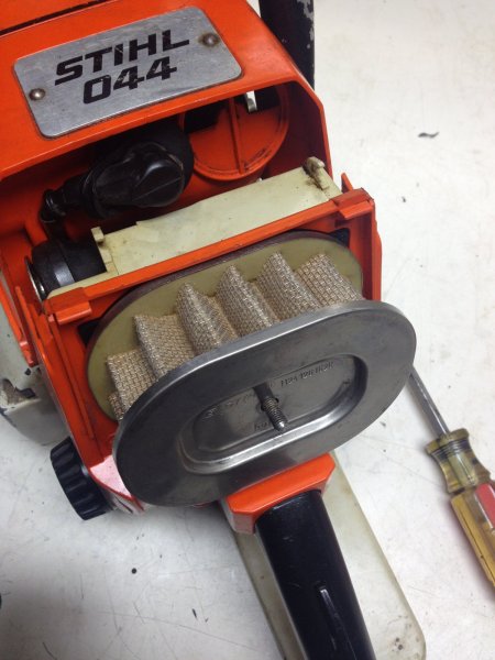

    Roger that. When I went out to warm my truck up this morning I remembered I have another 10mm 044 angled fin cylinder sitting on the shelf (no disassembly required). I grabbed a few pics quickly (see below). I'll try to remember to get a few more this evening based in your request.
    May I ask why you're interested? I've heard they changed the exhaust port at some point, so I'm guessing you're trying to figure the changes out? I won't be using this second cylinder for awhile yet - you want me to ship it to you so you can get a nice hands-on look at it?

    Muffler outlet pics ?

    Looks good Beau. I have an angled fin jug sitting in my shop. And from all the reading I have done no good way to tell between 10 and 12mm. I suppose one could time the jug against a known 10mm.

    No problem, but that'll have to go on the next week to-do list, sorry. To be clear, the side oulet on the can?

    Yeah, kind of a bummer. Luckily for me I have the saw the pictured cylinder came off of, so I could verify with the serial number. Other than that I think you might be correct in that port timing would be the only way to tell.
