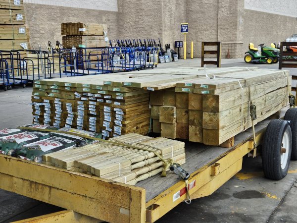

    Well, we got the job, I drew up a plan and materials list. They picked up part of the material from Lowe's on Sunday. Of course, the 20-2x8x12 weren't treated, only got a few of the pickets and half the bags of Quickcrete...:headbang::headbang:...in their defense, they had a small trailer and didn't know better...:picard::picard:...

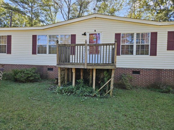

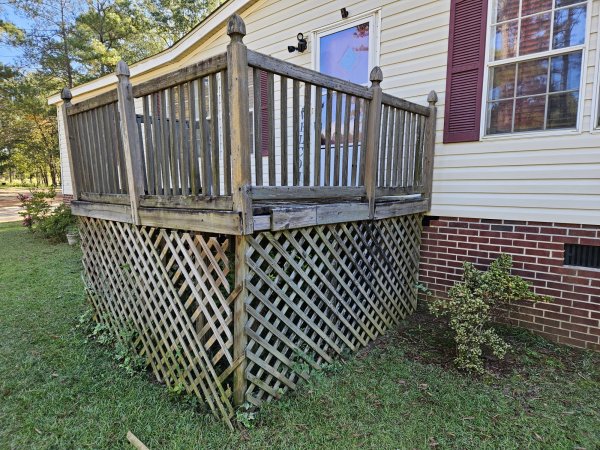

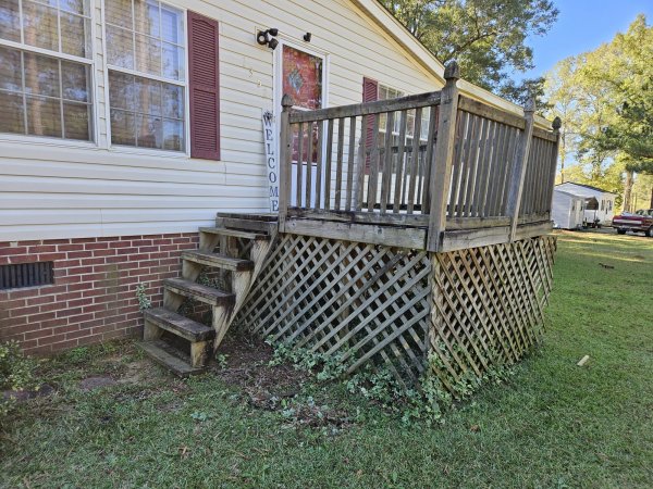

    We started yesterday morning, removing the existing deck... 20231016_104501.jpg

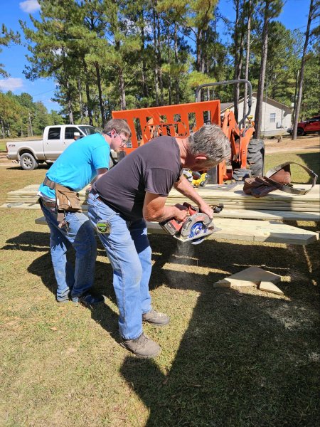

    Had that done and the wrong lumber loaded on our trailer by lunchtime. We drove the 35 miles to Lowe's, picked up the rest of the order and correct 2x8x12's.

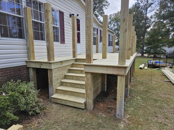

    It will be a 10'x23' deck with recessed steps...

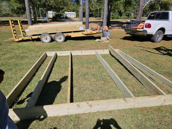

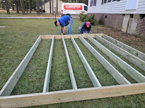

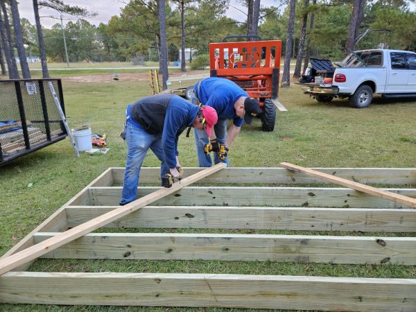

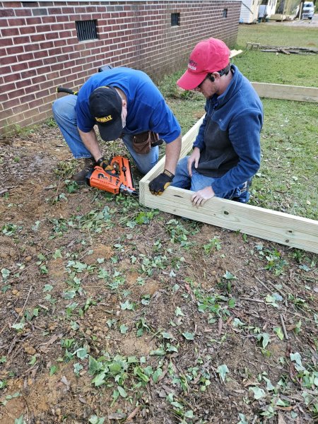

    Our son is helping us after he gets off work...3 ringshank nails and 2 3 1/2" screws in each joist.

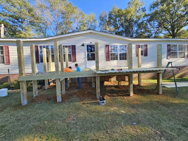

    Got half the deck built, joist hangers will be installed when it's off the ground... 20515.jpeg

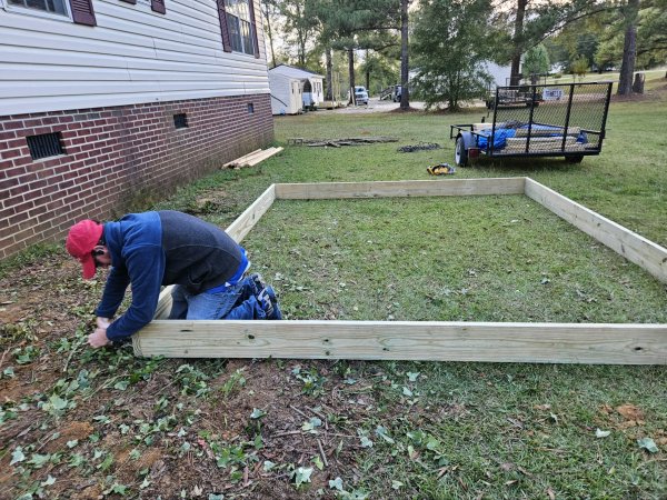

    We were only 1/8" out of square...:thumbs::thumbs:

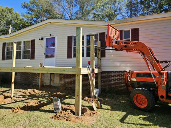

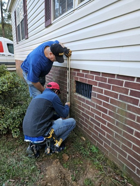

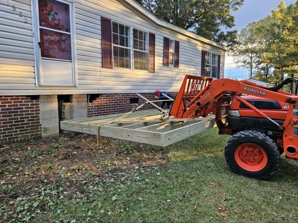

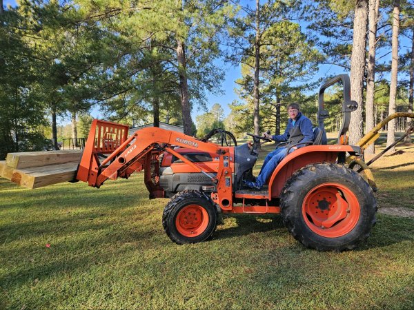

    We borrowed a 3pt tractor auger to bore the holes, which we will do today.

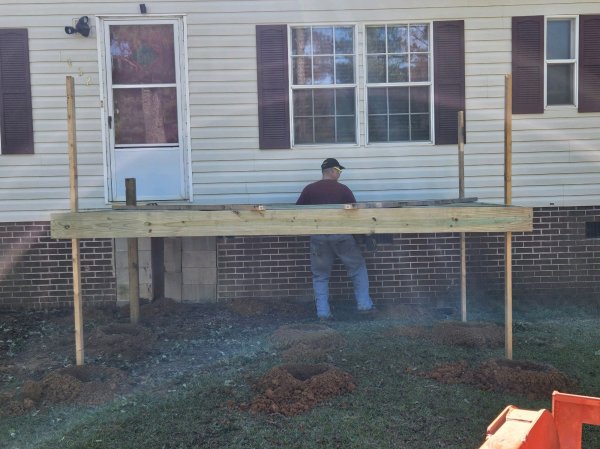

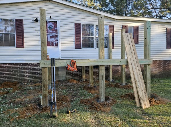

    Made some good progress yesterday.

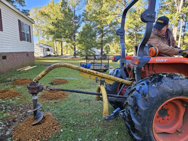

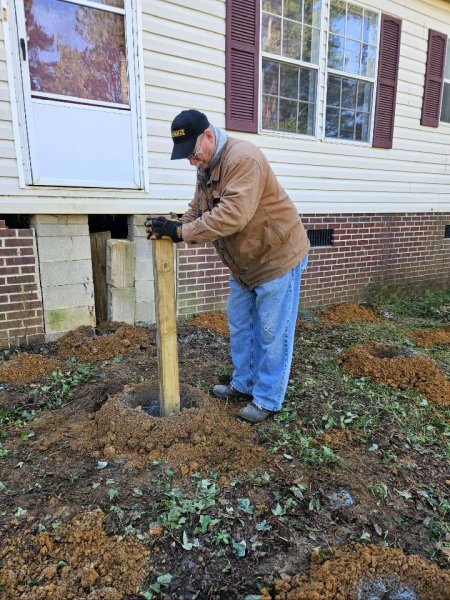

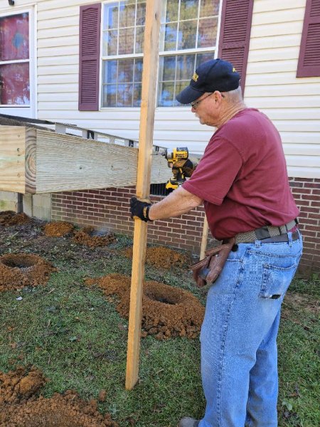

    Started boring the holes...glad we got rain the other day. That yellow clay was still very hard and very sticky. 20540.jpeg

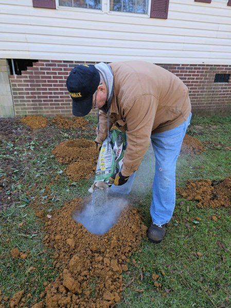

    Put about 25# fast set concrete in the bottom and tamped it down. 20542.jpeg 20544.jpeg

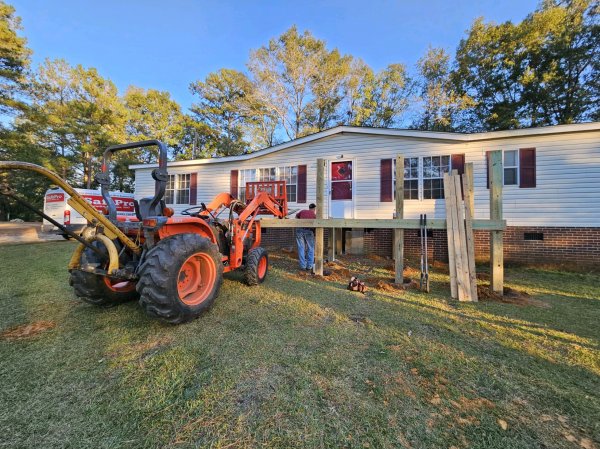

    Used the tractor to move section into place, setting the dead legs 20546.jpeg

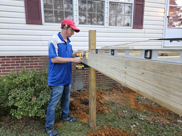

    Fastening deck to house with 3 1/2" screws 20548.jpeg
    We got the 2nd section built...steps will go somewhere in the wide area. 20562 (2).jpeg
    We will set more post this morning.

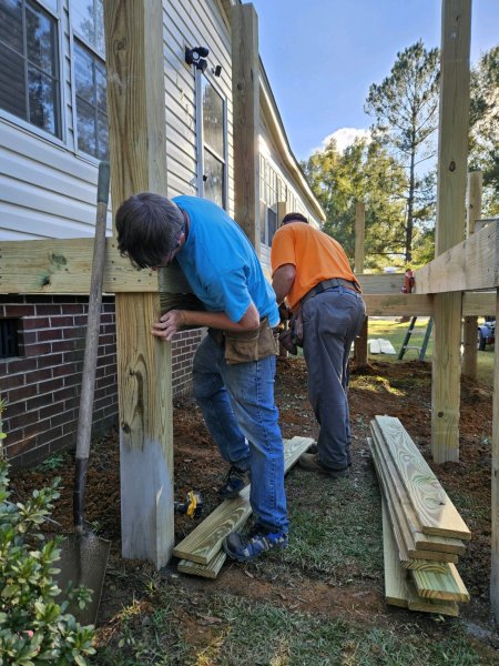

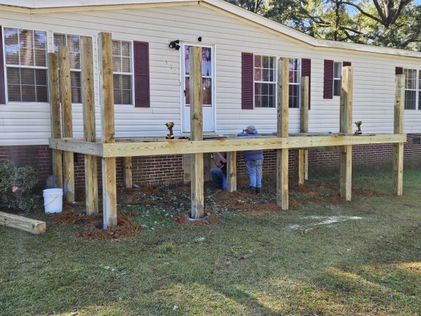

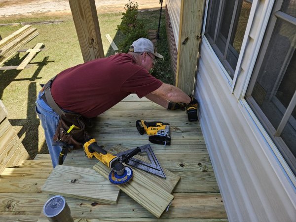

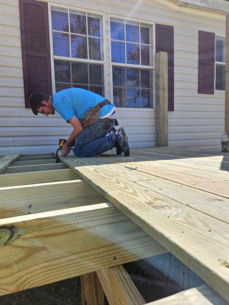

    Another day, more time spent with our son. He was a very big help today. Carrying a few 6x6's to the deck
    Getting more of the post set and nailing on the joist hangers 20231018_110724.jpg
    I had to go in to work for 1 1/2 hrs for some equipment training.He got more decking done... 20659.jpeg

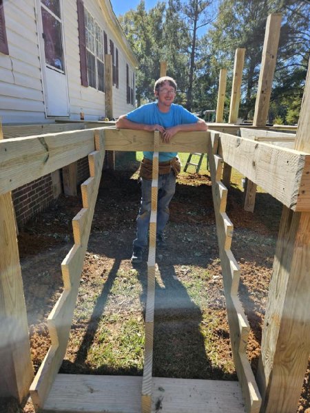

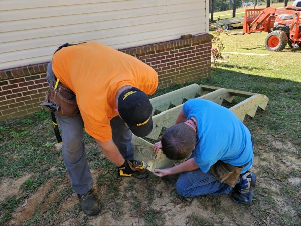

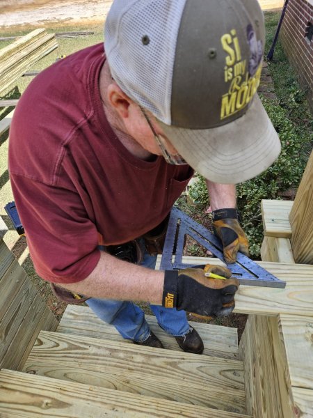

    A carpenter friend came by and helped draw out the stair stringers.

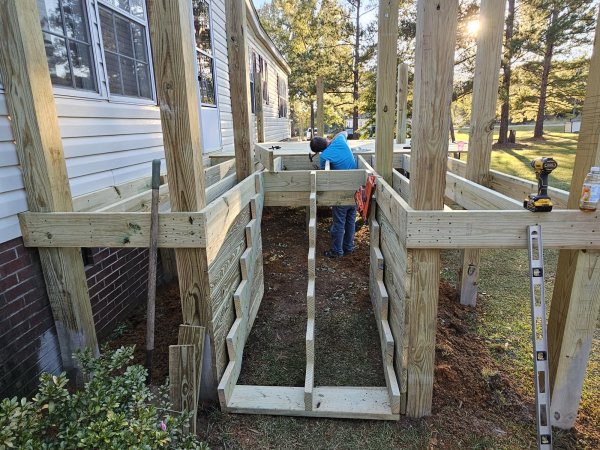

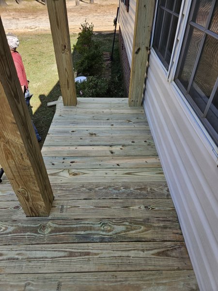

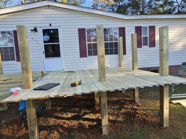

    All posts set now and shaker boards installed 20617 (1).jpeg We started closing in the stair well. 20651.jpeg

    Miz Carol and I worked yesterday, as our son had a full day at work. I guess we did OK for some :BrianK::BrianK: folks. We felt it last night...:pain::pain:...sore knees, backs and feet...

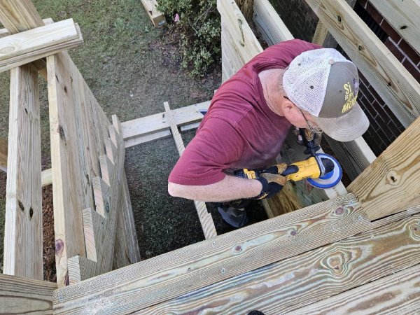

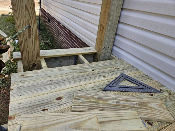

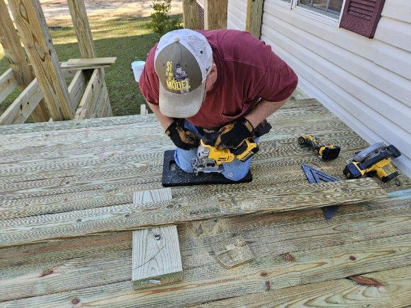

    Working on the decking 20231019_140436.jpg 20713.jpeg 20231019_141222.jpg 20231019_143000.jpg 20231019_143149.jpg

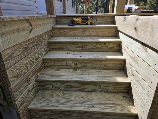

    We also got the steps done...leveling the stringer top
    We now have to cut post off, install rails and pickets, underpin deck with boards
