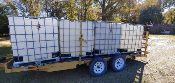

    I recently got several IBC totes from an oil distributor. Several have some leftover oil in them, from industrial diesel (train engine) oil to 140wt gear oil. I'm wondering if I could mix it with the summer grade bar oil I have now and it be OK to run in the saw?

    Thanks, there is probably 5 or 10 gallons in that tote...
    Even have a couple with DEF in them...I don't have a diesel truck... 1119211016.jpg
