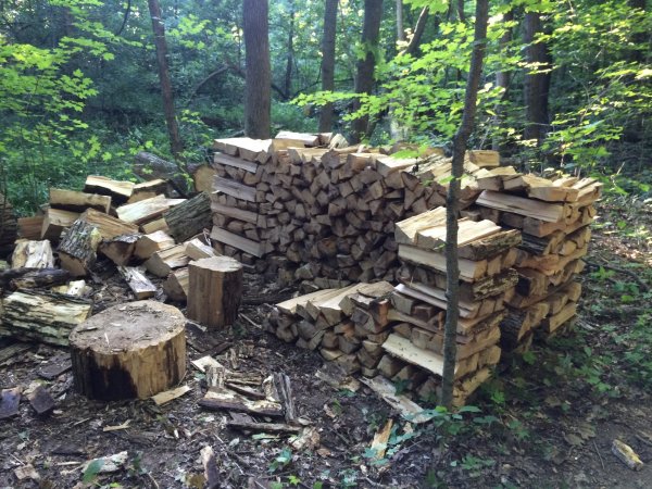

    Here is a couple pics of an ash tree I cut and split, being my first year cutting wood I am not sure how much to plan on needing,will take me some time but plan on getting enough for 3 year plan before winter!

    Dont even worry about how much you think you will need. Just keep C/S/S. If you have the room to put it don't stop.

    Welcome aboard Dmorris . What are you burning in and maybe we can help give you a guesstimate of how much you'll need. Also are you planning on burning 24/7 in the cold months or not.

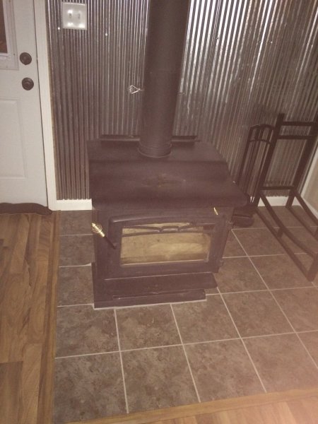

    The house we bought has a stove with no markings on it, looks a lot like a vogulzang stove, it has a blower mounted to the back of it, was professionally installed by previous owners, I burned it a lot last year while we were remodeling and it burns very clean with no smoke, throws out a lot of heat too, we moved in around February and burnt wood 24-7. My main goal is to try to save 1 tank of propane a year, think I should be able to do that fairly easy.

    My guess would be 4 to 5 cords maybe a shade more. If you post a picture of the stove someone on here might be able to identify it for you.
  8. papadave
    Welcome aboard, Dmorris .
    I'm in Northern Michigan, so not a great comparison, but we were told to expect to burn about 5 full cord every winter.
    So far (since winter of '06), it's almost dead on advise (except last year). Down there in TH, I'd take a WAG and say about 3 cords/year, so you need about 27 times what you have in the pic to be on the 3 year plan.

    Here is my stove, it is 24" wide, 21" deep,and 18"tall. It has 3 rods in top of firebox with a row of holes through them, and a plate that sits on top of the rods. My house is 2200 square foot but I can't get the wood heat to the front 2 rooms so I plan on getting a gas log for the front of house.

    Stove doesn't look like a Vogelzang. Looks more like a Century, US Stove Co., Country Hearth.
    The decorative window arches are throwing me.
    It's a secondary burn stove since it's got the tubes up top with a baffle.
    There should (hopefully) be a tag or plate on the back of the stove to help identify.

    I will have to look again at back, would like to know for sure what it is, I really do like it though, just put new firebrick in it.
