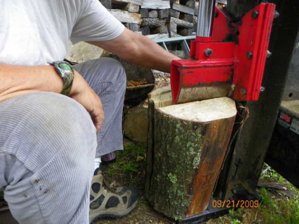

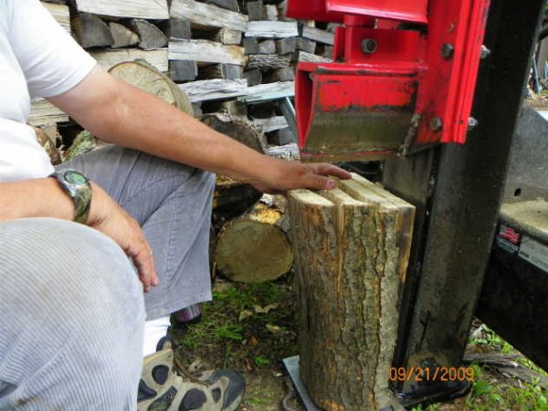

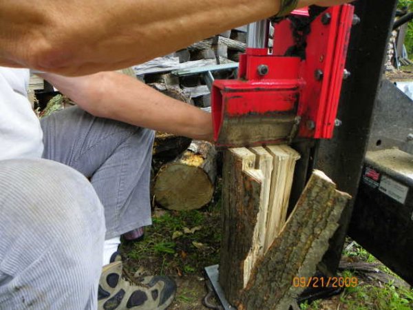

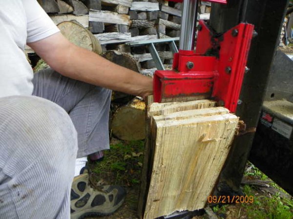

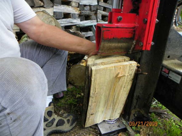

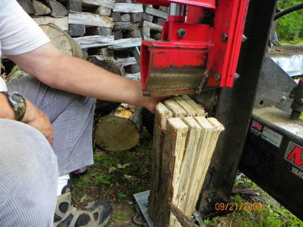

    My one question is that while you are starting to make the kindling with the splitter, why do you not finish it with the splitter rather than doing it by hand? It is less work that way and faster too.
    Here is what I mean. This one time I made some a bit larger than normal just because it was on the verge of being punky. It really is quick work this way.
    100_0112.JPG 100_0114.JPG 100_0115.JPG 100_0116.JPG 100_0117.JPG 100_0120.JPG
    In addition, sitting is better to see your work up close so you don't get fingers in the way. Also sitting is easier on the body, especially in the heat (and it is easier to reach for that beverage or cloth to wipe the sweat away from the eyes). Just a little hint or two from your uncle Backwoods Savage. ;)

    Valid points. I'll give you a couple of reasons.
    1. I don't like to use the splitter any more than I have to. We have a lot of houses packed pretty tightly so while I can legally use it as much as I want, I try not to use it more than I have to. In this case splitting the spruce is very difficult by hand and since I wanted to make wedges out of it, I decided to use it.
    2. I like splitting wedges with a hatchet to make kindling. It's a very satisfying process, like actually enjoyable. While it is slightly dangerous, you can see that I wear gloves and keep my left hand very low while holding the wedge being split. This greatly reduces the chances of hitting my hand. I've hit my hand once where it stung a bit. The hatchet is not too sharp either because it doesn't have to be, if I make my wedges thin enough. I also don't have to swing tremendously hard. By the end of that session I was getting more efficient in my strikes and swinging way less hard than at the beginning.
    3. Running the splitter costs money and I'd rather spend the gas on something I can't do by hand. For example, running all the debris I clean up through the wood chipper prior to being tossed in the compost. I find I can do it pretty darn fast using a hatchet.
    4. I need the exercise so I actually enjoy doing it by hand. I also like practicing my eye-hand coordination. I'm big into any sport that involves hitting a ball with some kind of bat - stickball, tennis, squash, badminton, hurling, etc.
    5. I don't like using the splitter in the vertical position because I find it cumbersome to move huge rounds into the proper position. Anything not huge I can lift onto the splitter in horizontal position anyways. I've used it in vertical only once or twice.
    6. It's faster to split the wedges by hand than to wait for the splitter. While making wedges is satisfying by itself it's even more satisfying to finish with the hatchet. I like hearing the clink-clink-clink of kindling popping off too. You can't hear anything when running the splitter and it's just not the same.
    7. You can't smell the wood when you are using the splitter. All I smell is exhaust. I love the smell of spruce kindling.
