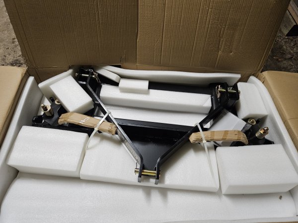

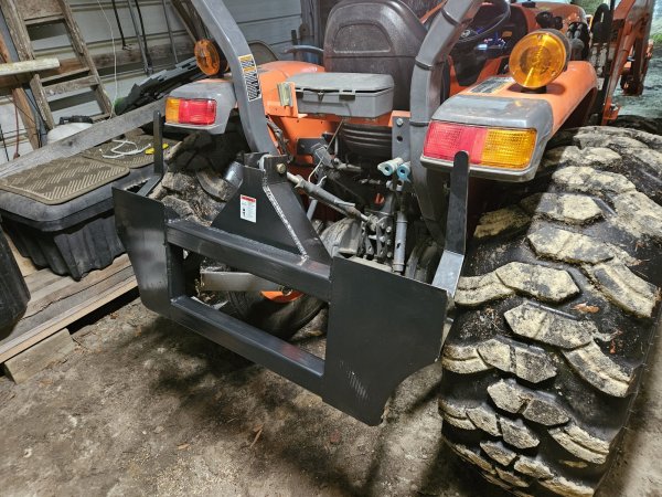

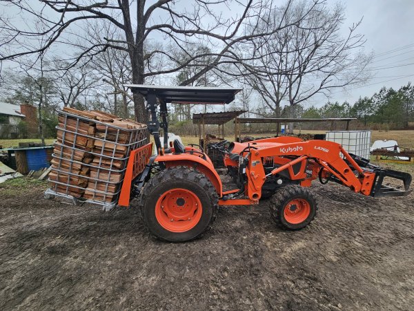

    1st package came Thursday while I was at work. It got put on and tried out that night... 20260226_190505.jpg
    3pt to QA adapter hitch from Titan.
    We looked at some on ebay, several different sellers, all the same pictures and descriptions...lol...they were cheaper...in several ways...:whistle:
    About 97# compared to 132# from Titan. Welds look decent, I saw a couple that would make WeldrDave :hair::hair::bug:... 20260226_192645.jpg

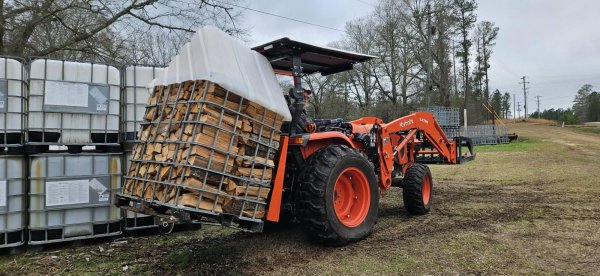

    Put the forks on and tried it out with a full 330gal tote of green oak. It's way heavier than our 6.5' Frontier harrow. It slowly picked it up at WOT, almost did a wheelie when I started off, got the grapple on the front made it much betterer. Probably need to leave a little room, put tote in storage, then add rest of splits and top. It handles a big seasoned tote fine. The 275gal totes green should be ok too. 20260226_193825.jpg

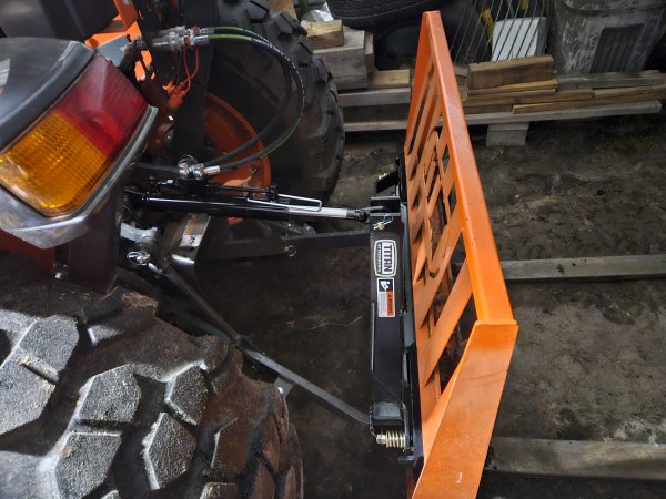

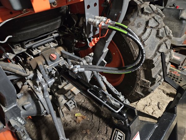

    Since we had rear remote added when we bought the tractor, why not use them... 20260227_191932.jpg
    If fact, before it came in, we were moving a tote, it was sitting on a slight downhill, had to put forks back on front to get it...
    I think this will work fine in those situations now...might even haul shorter logs on the back too.

    Did the L4802 pick up a loaded Tote?

    Putting the weight on the back with that being the heavier axle makes good sense. It will drive nicer too.

    Seems like the hydraulic top link is the trick...

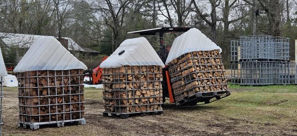

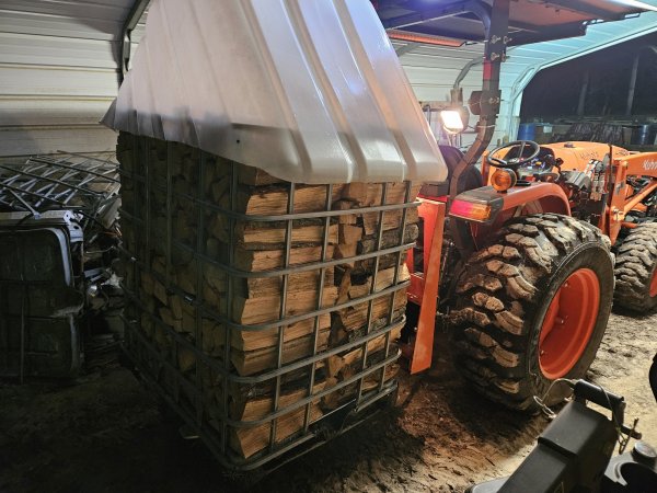

    Back under tote... Messenger_creation_2BC27B90-BDEA-419A-8A11-F400856C903C.jpeg
    Tilt forward and lift... Messenger_creation_08504CF4-1077-4183-98E7-9A7F71742F4E.jpeg
    I had put these 3 totes in storage the wrong way, want the door facing tractor, so when we load later, door is facing rear of truck. Pulled them out and turned them around. Messenger_creation_DE8890BB-9438-4179-8992-EBA1B693D4E0.jpeg
    This oak was split Wednesday night, stacked it Saturday morning, it was the heaviest of the 3. Struggle but made it.
    20260228_101110.jpg How about double duty...:eek::eek::binoculars::)... 20260228_140119.jpg

    Sorry, I meant with the front forks ? The rear looks awesome. Looks like everything is working really nice!!:yes::cool:

    The hydro top link is a great upgrade! I’ve got one and use it all the time in the woods to get the skidding winch to dig into the uneven ground. Also makes hooking up implements easier as well.

    It would, barely. Had to keep lever pulled back, WOT, and kinda rock tractor back and forth to get it off the ground. Knew long term, that wasn't going to be good.
