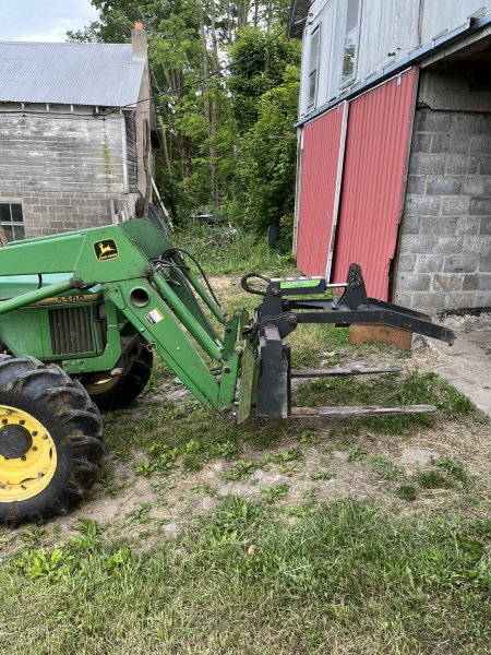

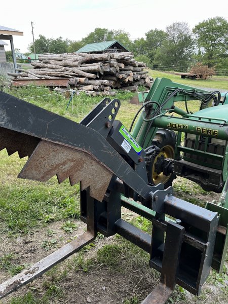

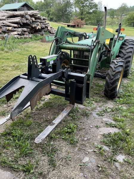

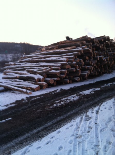

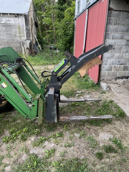

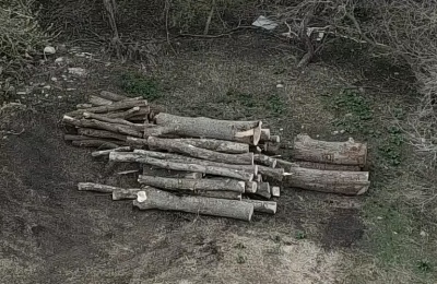

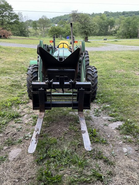

    Hello friends I am exploring a grapple that might work better for me than what I am currently using. 99% of the time I am picking logs off of a pile set by a triaxle log truck. The grapple I have right now is a set of forks with a grapple attached the problem is my sight is limited by the loader frame etc. & always seem to wind up with to many logs on the forks. We have a decent sized 70hp utility tractor but when all those logs roll on the forks it puts a lot of stress on the loader arms & make the rear end light. I feel like it’s also hard on the front axle (difficult to steer) I been looking at the Frostproof grapple & the Wicked grapples. Just wondering if any you have any experience or advice on these grapples for what I’m doing. I’ll try to post some pics of what I’m currently using & the log piles I’m picking off of. Thanks!

    That’s my problem with the fork grapple, can’t see where I’m at in the pile or how many logs I’m under. Are you liking your new setup? Your probably not using for the same purpose as I am. Thanks!

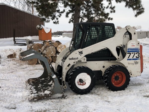

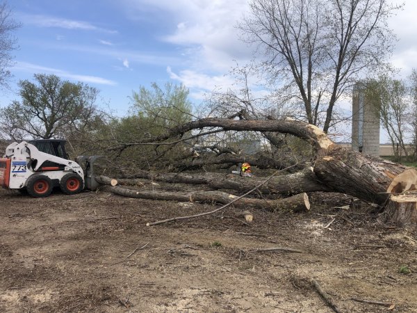

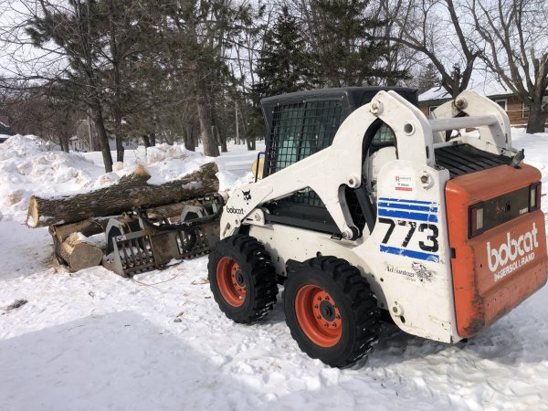

    I use a combination rock/ brush double clamshell grapple. I borrowed it from my cousin so it’s showing me it’s strengths and weaknesses for what it’s capable of and about the only weakness I see it’s it built too light. He runs a new Holland machine the same size as my bobcat. Helps we can share attachments.
    the double clam shell is plumbed parallel so they both close with the same pressure, but if one side is smaller than the other, it will close accordingly.
    This model ( company is no longer in business) flexes and over centers the clam really easy. I could tear it apart if I really wanted to not watching what I’m doing.
    works really good for cleaning up slash as well as grubbing out smaller trees and brush for clearing.

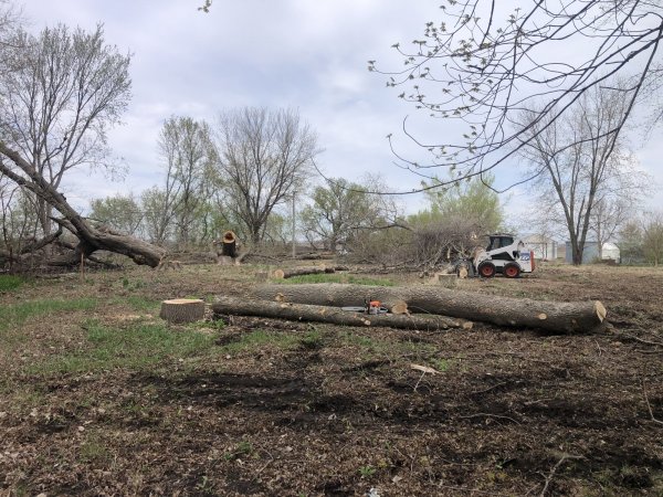

    That center stack is mostly all 13’6” or longer “16” lined” longs off the property.
    I can see a need for three styles of grapples in the wood yard.
    Double clamshell like this would be good for loading splits out of a pile and letting the debris/ dirt fall out.
    wicked grapple would be good as a rootrake and a landscape rake
    and dedicated log grapple like Chris at In the wood yard.

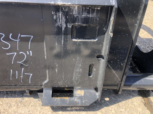

    the quality of the product is hands down notable between the three. With titan being the cheapest (worst built) option. How the frame is attached to the implements vs the quality of the steel etc.
    This is how the plate is attached on an actual bobcat bucket. Titan is lighter gauge material as well as the eye welds aren’t there.
