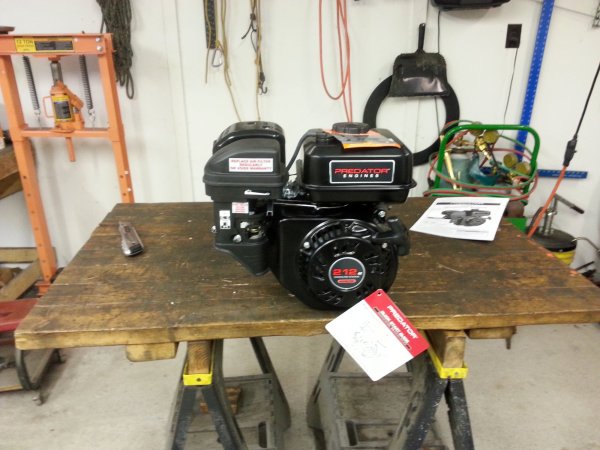

    Last day on sale at harbor freight was today so I picked up the new motor for the old splitter. Now all I have to do is dig it out from under 3 feet of snow and install it. Anyone have an ETA on spring? 20150228_165125.jpg

    Nice looking engine. $99?????????

    They have coupons for that motor for $99 all the time.
    Of course when its on sale at $99 you can use the 20% coupon and get it for $80!!
    My buddy put one of the previous versions on his splitter. The blue motor. Its an exact honda clone. And it is a sweet running motor. Good on fuel on his splitter. And starts right up on first or second pull if it sat one day one month or 4 months.
    Its been on about 3-4 years now at least. Does not burn oil or anything. If it gernaded today id buy another.

    The ads I've seen in car mags for harbor freight with the 20% off coupons state no predator power equipment can be bought with the coupons. I've been looking at their splitters, and sure enough they have predator motors on them. They are Honda gx clones, and will accept many honda parts. They work pretty darn well from what I hear.

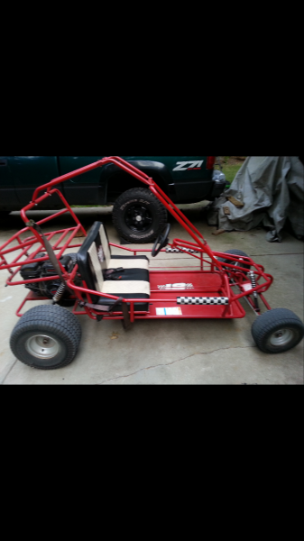

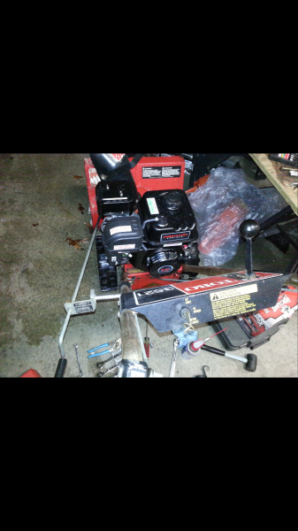

    I have the same one on my old toro blower that was an easy swap. Runs really good. Also have one on my boys go-cart.
    Only problem with them is they are set extremely lean to pass epa regs. You'll realize this when to try to start it when it's hot and have to full choke it(my experience). You can buy a different emulsion tube and jet to richen it up, takes about 5 minutes. You can also use some mix in the gas tank, maybe 50/50 straight gas/mix to help with break in.
    I have been running the above mentioned mix in mine and it runs extremely well. I've pulled the plug after each use and see no carbon buildup anywhere. My thinking is a little extra lube to break in the piston and rings. Also, with the mix in the tank they start right up without choke when warm(can't explain that one, but it works).
    Just thought I'd share my experiences, I'm no expert but the cart has a ton of hours as the kids run it ragged and I'd buy another one without a second thought if it ever gives up the ghost. Happy splitting good luck with the swap!
    Pics of predator powered stuff:
