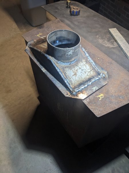

    I just installed a Craft 4830 in my basement fireplace. The stove had a rectangle shaped exhaust hole. It was at least 10" x 16".
    I fabbed and welded up a transition piece that
    reduced the exhaust to a 6" pipe so I could connect to a 6" chimney liner.
    It drafts and burns fine. No issues at all.
    Your 8" to 6" transition should be ok.
