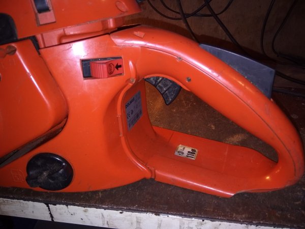

    The saw...
  2. AlfA01
    AlfA01
    Nov 3, 2018
    175
    1,393
    Evia Greece
    It's a little rough, but not too bad overall.

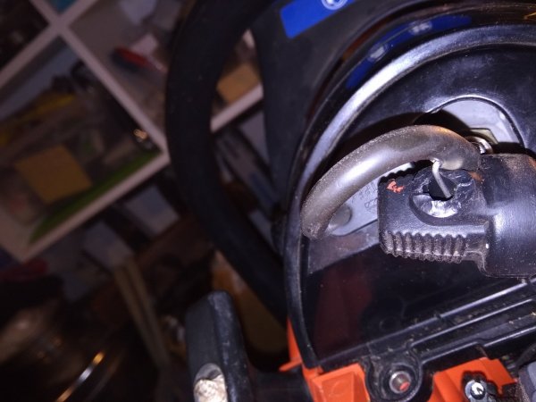

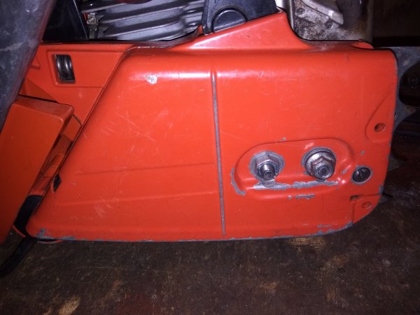

    First, the teardown...

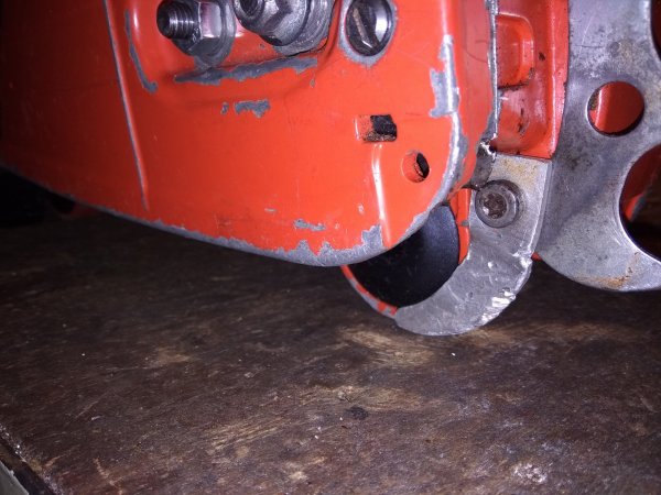

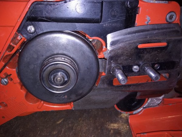

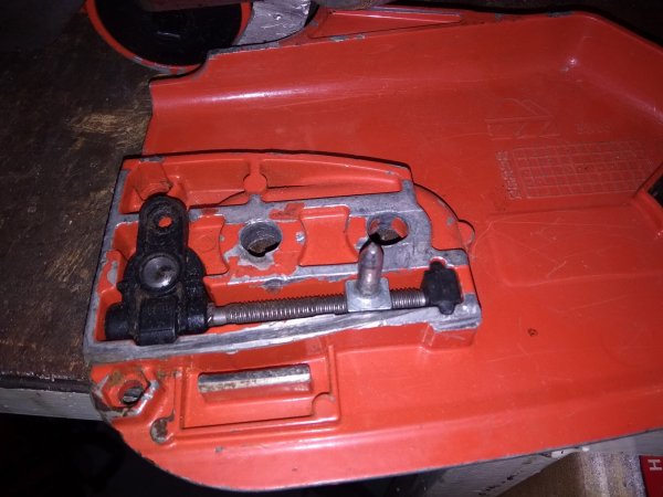

    PO used a regular nut for replacement bar nut.
    Chain catch has taken a beating. IIRC I have one somewhere.
    Some chain rash under the clutch cover, but it looks decent enough to use.

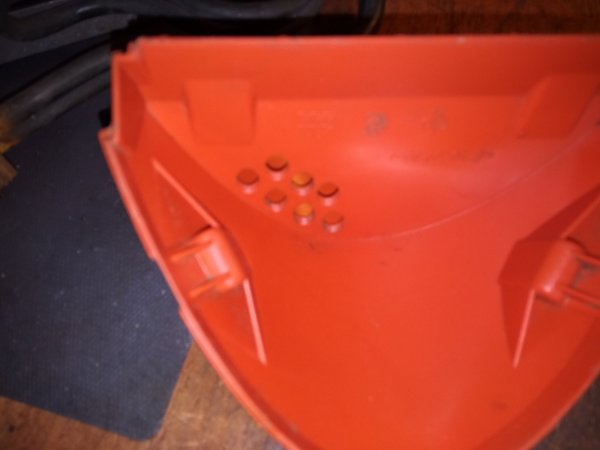

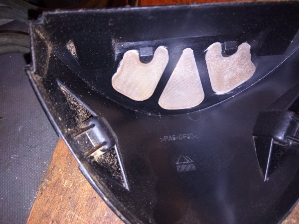

    Under the top covers...

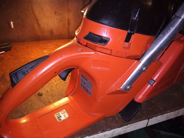

    Older red top versus newer black top...

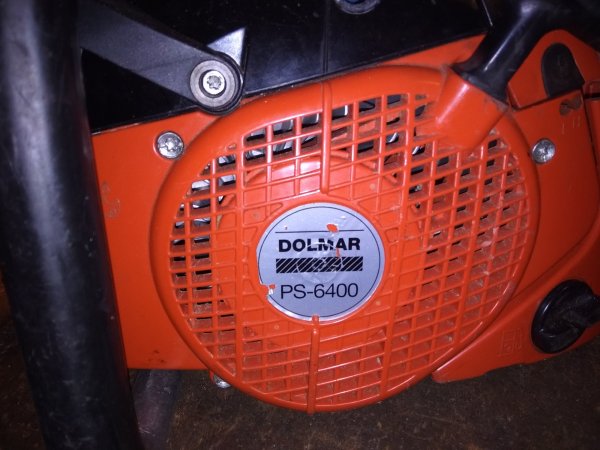

    2003 PS6400 Dolmar versus
    2007 PS630 Dolmar - the newer models have some pre-filter material similar to Frogzskinz...

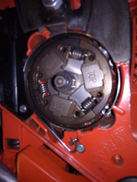

    PTO side...
    Clutch appears solid...

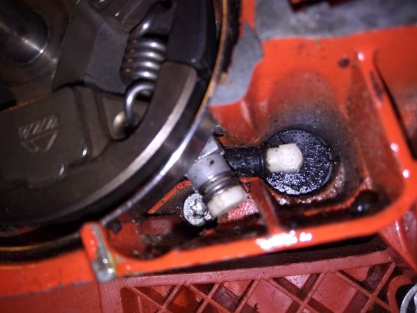

    Oil tube shows some leakage...nothing Yamabond shouldn't take care of...

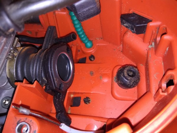

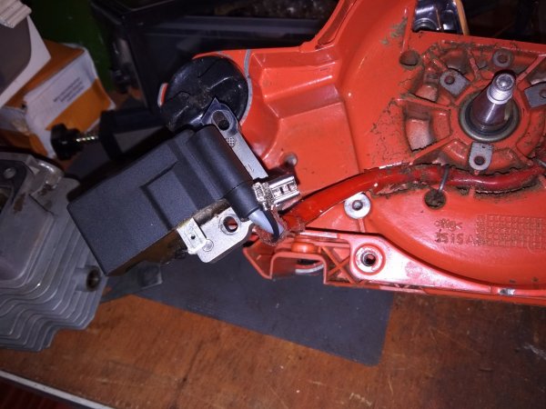

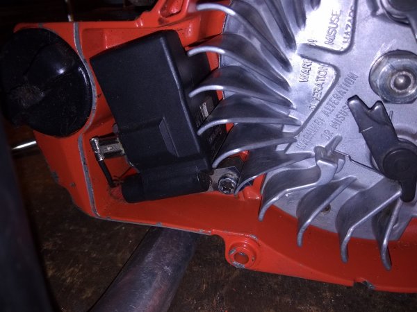

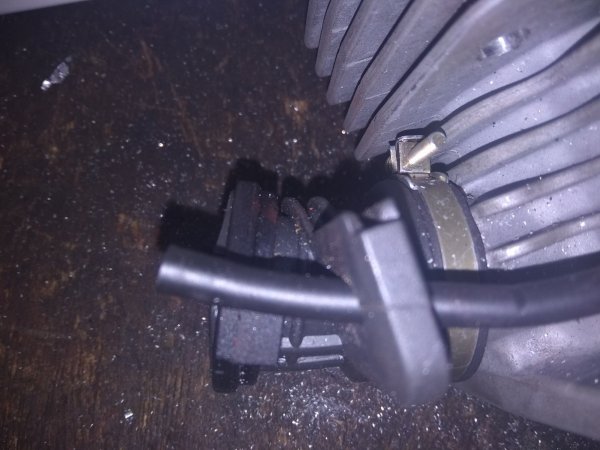

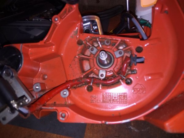

    Well, it appears someone has replaced the coil at some point.
    This saw has the black coil that is limited to lower RPM's.
    Typically the 6400's had a maroon coil that is higher RPM.
    Oops. Doesn't look like the sparkplug boot was installed correctly.

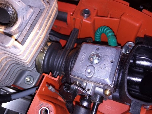

    This one has the Zama C3M carb. Model 11A, I believe.
    Carb removed. Pretty clean overall for a 2003 saw.
    Old style cylinder with decomp on the flywheel side....
    Edit: and yes, that is electrical tape on the plug wire. It looks like it was too short and they taped on an extension.

    Time to get rid of this black coil....found a new maroon one out of Estonia on eBay.

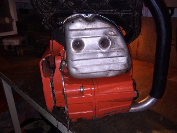

    Starting to do some mods while I wait for parts...
    Fitting a Red97 large deflector where the small Dolmar one once was.

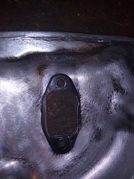

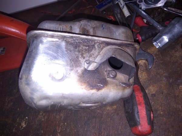

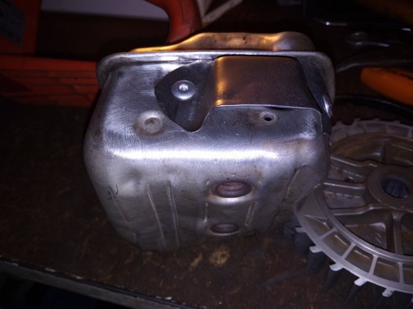

    Some more muffler mod pics...

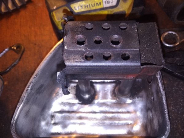

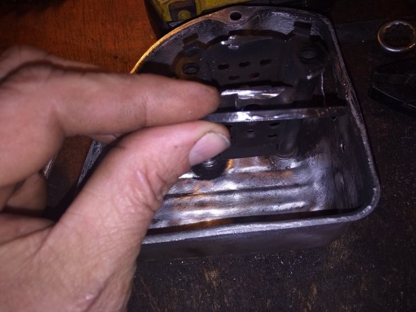

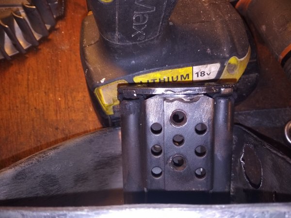

    I drilled the temporary rivets after fitting the deflector and opened the can up with propane torch and screwdrivers.
    Here's the birdcage....I'm totally removing this gadget.
    I cut the welds free with a cutting disc on my angle grinder.
    The birdcage slides free of the mount posts.
    Front of the muffler inside view with all the garbage removed.
  14. AlfA01
    AlfA01
    Nov 3, 2018
    175
    1,393
    Evia Greece

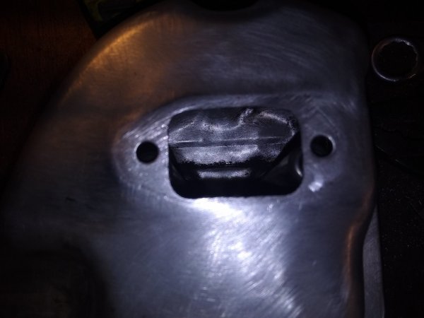

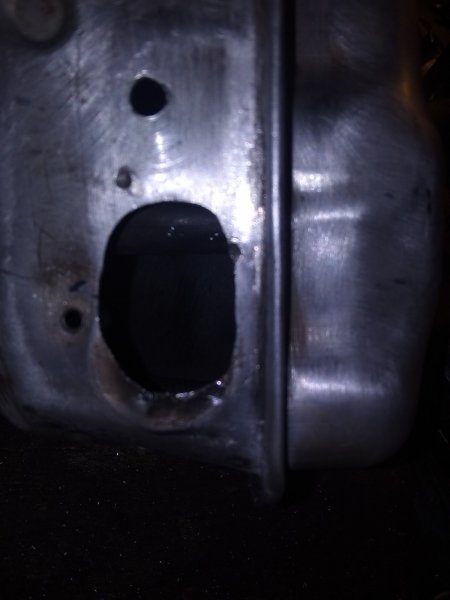

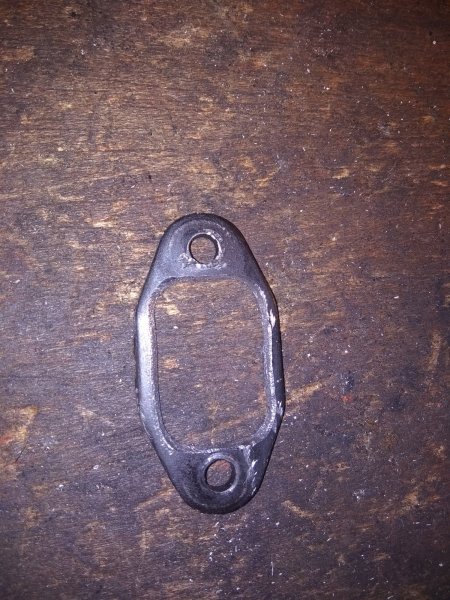

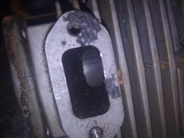

    I opened the exhaust inlet and port matched it with a ported cylinder I already have...
    I opened the exhaust outlet to about 80% of exhaust inlet...
    This is the flange I cut off the bird cage. It is also port matched and will be brazed around the exhaust inlet for support....

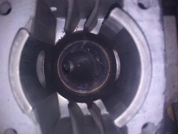

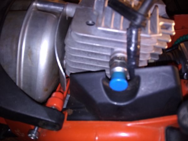

    Here's a look at the old cylinder. Open port design on the 6400. 47mm bore and 37mm stroke.
    I'll be going with a closed quad port design cylinder for the build.
    Intake boot setup.
    There was some scoring on the old piston....
