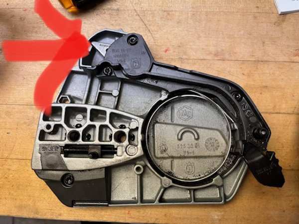

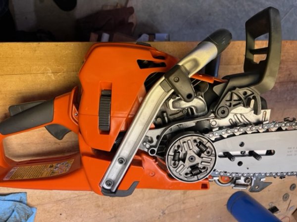

    Santa brought me a 562XP for Christmas. I’ve always run Stihl chainsaws, but Santa decided I needed a change so he got me a 562XP.
    Being an inquisitive person I decided to take the side cover off yesterday after reading a post on here about the different clutches that chainsaws come with.
    When I took the side cover off I did have to wiggle it some but didn’t think anything of it. Well, I guess I made the dreaded mistake of taking it off while the chain brake was engaged. Watched a couple YouTube videos but it looks like their covers are different than mine. Anbody have any suggestions on how to disengage it ?
    I’ll have to inform Santa that this is a Stihl only house going forward…..:p

    Line up the bar stud holes trying to put it in place, and push the top right corner of the clutch cover in while you pull back on the brake handle. You will be able to get the brake mechanism to engage just enough so that you can take the brake off

    Yep, that’s what I did.
    Thanks a lot.

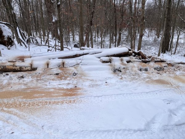

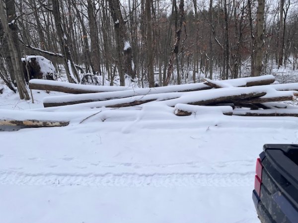

    Man, can that thing cut. No real bogging down in anything I was cutting. Most stuff I’m cutting is <16”. It currently has a 20” bar with what I’m assuming is X-Cut chain, there’s a gold link. I probably cut for 15 minutes or so and made a decent dent in my log pile.
    Ordering a 24” bar to tackle the red oak trunk blew over in the pics. The tree itself if probably 4’ DBH. That will be fun….
    Took it a few pulls to get it started on both a warm and hot start. My Stihl’s normally kick over after four or so pulls, and then one pull on mid-choke and they are off. This was probably six or so. I’d assume as time goes on that should get better.
    Attached a few pics of todays adventure.
