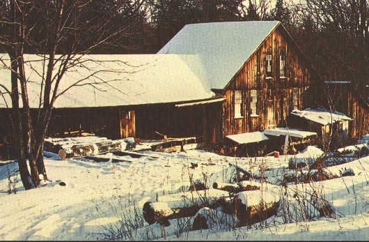

Looking for any more mills? My dad has a mill that's probably about a similar vintage he has been trying to find a home for. He's almost to the point of just tossing it in the field because he can't find anyone to take it... I think this is where it was originally house but I'm not 100% sure: http://stonehousemuseum.org/images/Belchertown/pc_prattssawmill.jpg
We also have an Amadon portable mill in operation at the museum and a couple more Lane mills, a #1 and an #0 i believe in piles for parts. That being said, if you have more information on the mill and it's condition, photo's etc, I'll bring it up for consideration.

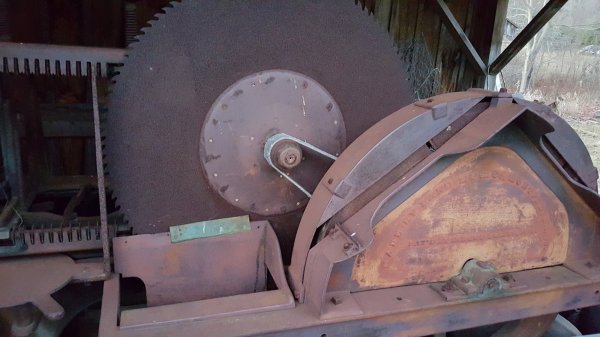

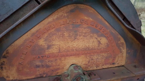

Checked with my dad he says it is a chase no. 2 rack and pinion mill. It's had some modifications over the years (including at least one part that says lane). I took a couple pictures of the business end of it which has been removed from the building (under cover in a shed) it was too dark to get pictures of the rest of it.
that looks to me to be a lane shingle mill. the teeth in the second photo is to hold the cedar block and the chute next to the blade is for the shingle to drop into after cutting. i'm going to forward this to a couple of our guys for their thoughts. more pictures when you have a moment - and daylight
yes it's possible I was looking at the wrong one, I know he has a shingle mill as well, I had thought he pulled the main part of the mill out of the building but maybe it is still in there and I was looking at the wrong one. I'll have to take a look when I can get back over there. If that is the shingle mill (which I am thinking you are correct on that) I don't think that is the one he is looking to get rid of at this point. I'll try to get more (and correct) info.
That is very much a shingle mill. The wedge mounted on the blade and the block turning table are also clues. I have a DesJardins shingle mill with similar features but mine was built in the 50's or 60's and has a trimming saw blade as well.
