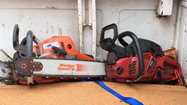

    2252 w/ 18" .325. It balances fine, but I think the saw's a bit underpowered. 16" would be better on a 50cc, IMO. image.jpg
