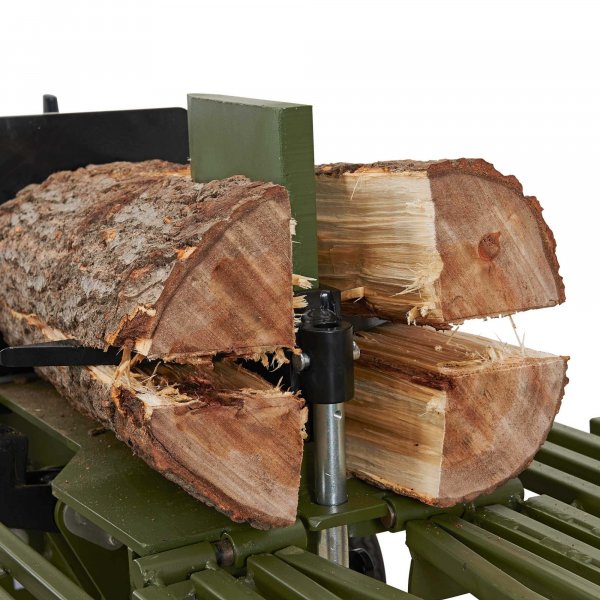

    I often thought about getting a 4-way wedge for my old 27-ton beam splitter but never did. I have both a 4-way and a 6-way slip-on wedge for my 35-ton splitter but have yet to use either as I am so used to just splitting with the single wedge and being able to 'shape' my splits. I intend to experiment with the 4-way wedge this spring but see little use for the 6-way. One advantage I have over the typical beam-type splitter is that I can hydraulicly adjust the position of the 4 or 6-way wedge which makes it more useful than one that is in a fixed position.
    Not my picture but the same splitter. The silver vertical rod that the wedge is pinned to can be hydraulicly adjusted to position the wedge depending on the size of the round being split.
