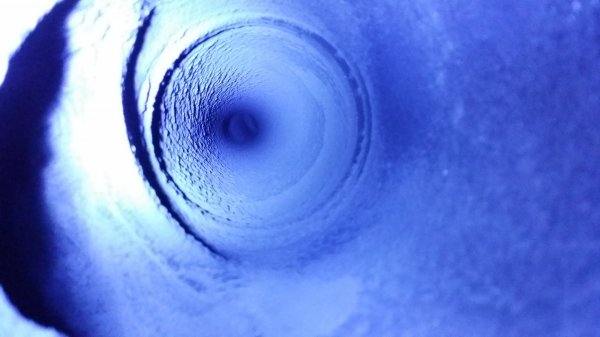

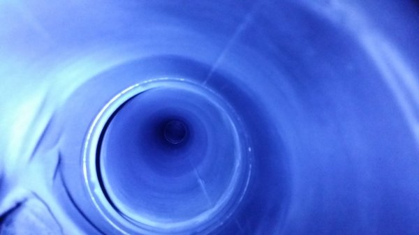

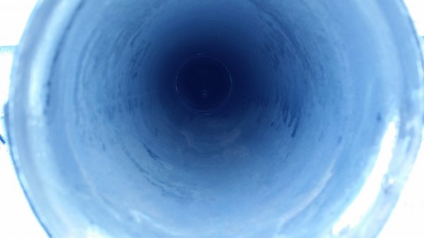

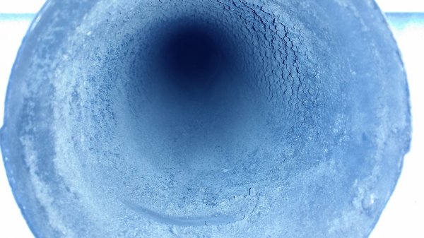

    This is my Fahrenheit Endurance pellet vent after 2 ton. In my opinion, it's really not that bad. About an 1/8" on the sidewalls on the vertical and horizontal and maybe 1/4" deep in the very bottom of the horizontal section.
    I was going to do the LBT. But it has been Uber cold here. So I hooked my big 6 HP Shop vac up to the bottom of the Clean out T and ran it while I ran the Lint Eater up and down twice from outside.
    This is the Vertical section before and after.
    And the Horizontal section before and after.

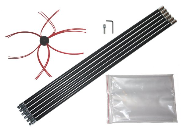

    I did that last week from the inside up...This is the kit I use, the rods are very stiff (shut up SmokeShow) but they do bend enough. You would probably have to fight it to get around the 90, but I think it would go!
