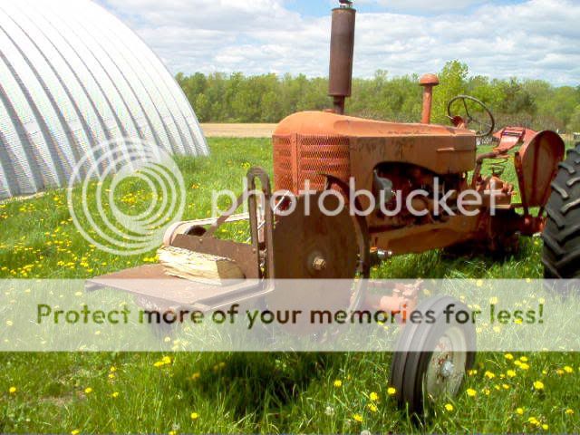

    I had one that mounted on the front of our Allis WC that fliped up for transport and used a flat belt. With my dad running the table and my brother and I lifting the log up on the table and then me going to the cut off end and pitching The cut into the wagon it worked great.
    Then we got rid of that old WC replaced it with a Ford 2000 3 cylinder. it had a big front loader on it so the buzz rig wouldn't work.
    We went to cutting our fire wood with the chain saws and quickly found it a pain in the back. I ran across a right angle belt pully for the Ford N series tractors welded up a bracket and mounted it to the old buzz rig ran a flat belt pully on to the buzz shaft and used a couple hood springs to tention the belt. Made a shaft from the right angle belt pully to the PTO on the 2000 ford and we were back in bussness and happy. With either set up it was easy to move from wood stacked in a buzz pile to another buzz pile, where ever we could fit a wagon or trailer to haul the cuts away.
    I sold the set up a year ago. since dad has passed and brother and I now live 3 hours apart so we would have to have a way to travel and take the tractor and saw with us. Brother doesn't heat with wood how ever.
    I picked up a front mount buzz rig I mount on the Front of one of my Masseys every so often. Go to a stack of piled up stuff set the rig down on its legs add the belt and start cutting I let it just fall on the ground and when the pile gets so big I back the tractor up with the buzz rig and go back to work.
    Mine has legs on the saw.
    Latter I return with the wagon and throw the wood in there. About the biggest is 6" in dia.
    Ya the buzz rigs are worth it.
    :D Al
