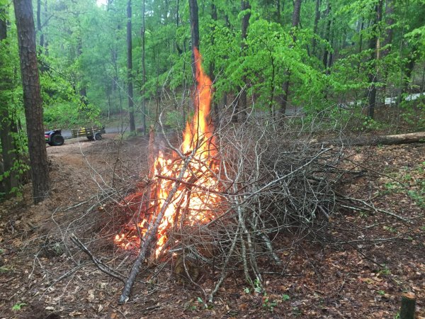

    I think I'm going to wait on the chipper, finally had a decent day to burn

  13. fuelrod
    fuelrod
    Oct 4, 2014
    3,494
    20,424
    Western Maine
    WOW IS IT GREEN DOWN THERE! :thumbs:
    Look in the top left corner of the pic Basod. 2 days ago:rofl: :lol:
