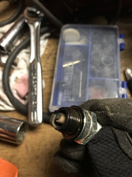

    Sounds pretty rich. Could be wetting the plug enough after a cut that it can't idle.

    So tried leaning the L a bit. ( took it to the point of wanting to stall then backed out to have decent throttle response, still around 3-3100 and the LI screw is all the way out) I then leaned the H up to 13,3k and it seemed to gain and pull nice in the cut. 9800-10,100 in the wood. As soon as I realease the throttle it falls on its face. I saw as low as 1800 then if it didn’t stall it slowly rolled back up to 2,6-2,8 if I let it idle a bit it would come back to 3k. Then it started to be a bit sporadic as far as numbers, not by much though. Here’s the plug. 9478DD69-7929-4863-8981-D4DDBE08518A.jpeg EAB3BB7B-B6AF-4A0B-AB57-9DB4334CD0E9.jpeg Tried sticking the OEM blue coil back on. Adjusted some settings, idle at ~3100 and wot 13,1-13,2 seemed to pull good as before and still stumble some after the cut. The other thing was the exhaust bark came back on start up.
    Conclusion...
    May need a carb ?
    New OEM coil?
    Vacuum/pressure test?
  18. mdavlee
    mdavlee
    Oct 21, 2013
    4,380
    10,479
    Where is the L?
    p61 western, J. Dirt and huskihl like this.
  19. huskihl
    huskihl
    Jan 30, 2016
    3,652
    20,852
    I bet there's an air leak somewhere with the idle being backed out
    p61 western and J. Dirt like this.
