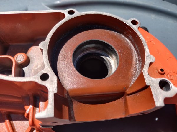

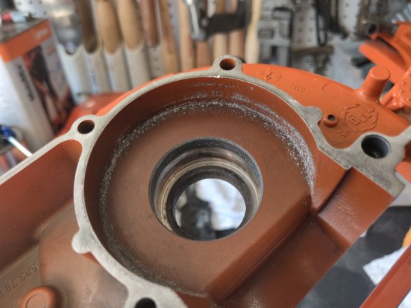

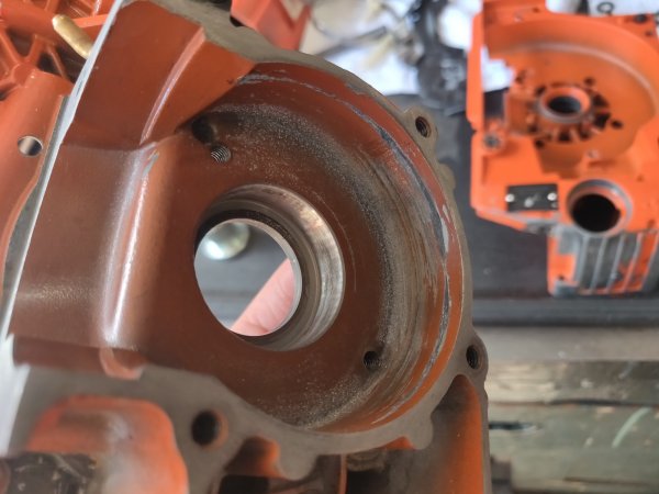

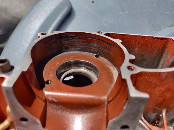

    So this is a 2012 372xp x-torque that had the connecting rod bearings blow up. Destroyed the piston and cylinder.
    I've got a meteor piston and cylinder kit and a Hyway crankshaft and SKF bearings, seals and gaskets ready to go.
    I finally washed the parts using my STIHL parts washer and now I'm wondering if these scratches from the bits of needle bearing flying all over the place should be of concern.
    You can most definitely feel the scratches with your fingernail and even after washing it there were specks of magnesium. I was able to wipe it clean but I wonder if this is going to cause an issue down the road.
    huskihl BuckthornBonnie M2theB wudduya guys think?
    I think it should be ok. Perhaps I can send with 250 grit just to make sure there aren't any big chunks that might pop off.
    Thanks in advance as always.

    I’ve haven’t dealt with a case inner like that before
    I think as long as you can get a good interference fit on the bearing and the seal surfaces are smooth, I wouldn’t think the dings in the case will hurt it. May be picking up a tiny volume on the primary compressor, but not enough to worry about.

    Penn Yan, NY
    Yep, the dings are fine unless chips break off. I’ve built many saws with case damage worse than that and have had no issues. Yes to sanding and smoothing, just be mindful of that paint/powder coming off too much. I do not paint the cases and haven’t had any powder coated.
    I don’t flip or sell saws, though… just fix them and run the heck outta them.

    Magnesium won’t hurt the motor. That being said, wipe it off, spray it off, blow it off.. whatever you can do to get rid of it.
    Make sure the bearings are still tight in the bore. I always red loctite my bearings on a rebuild. But it’s not for everyone. Takes some practice to make sure the cases are hot enough so you don’t have a bearing half installed and stuck there

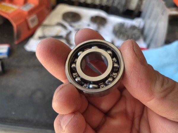

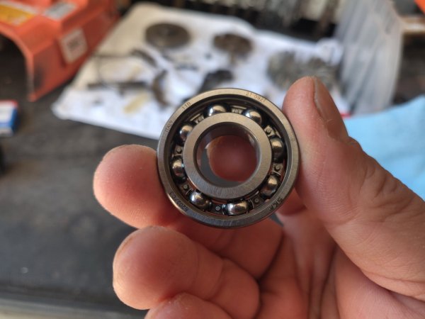

    The SKF 6202 bearings I got are steel caged with rivets.
    Here's a pic of each side.

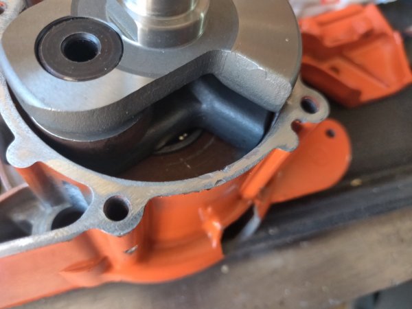

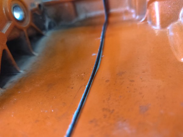

    Thanks for everyone's input.

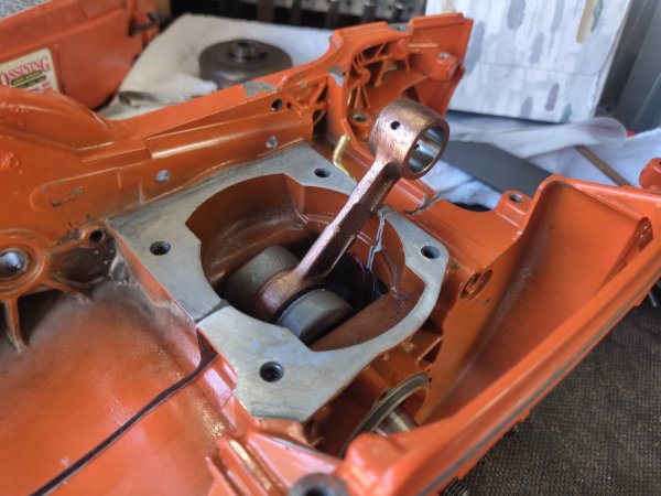

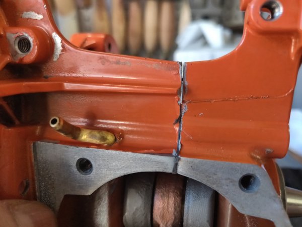

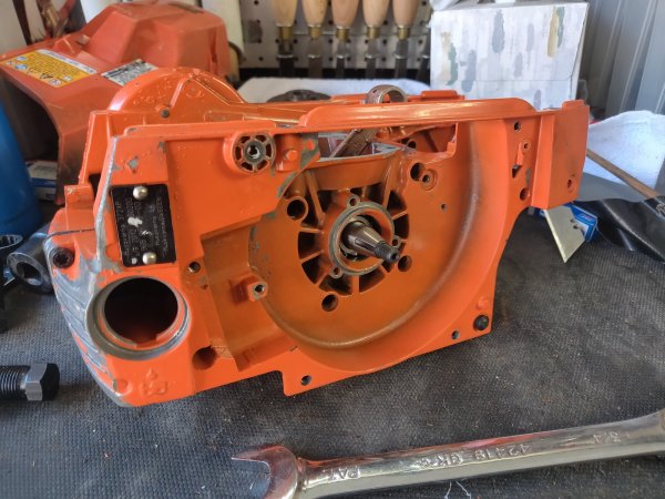

    So I went ahead and lightly sanded the inside of the crankcase then brought the halves inside to wash with soap and water.
    Went to install the PTO side first and did not get the case hot enough. Mistake #1. More of those in a minute. That resulted in me tapping the bearing in more than I wanted to but luckily it went in ok.
    Then I used the oem assembly tool to pull the crank in and stupid me got the connecting rod pinched against the case. NOT GOOD. Ended up gouging the case but luckily again, not to the point of no return....I hope. I was able to tap the crank once and back it out....except the case was still warm enough that now the bearing came out too. But because I had pinched the rod I couldn't use the OEM separator tool to push the crank tool out.
    It looks like there was enough meat left that this shouldn't be an issue but obviously it would have been ideal not to damage the case. After unpinching I pulled the bearing and the crank back in with the assembly tool and rotated the crank and gently filed the case where the damage occured.
    :doh:
    Used 1184 gasket maker on both sides of the case. The flywheel bearing went in way easier. No issues pulling the cases together.
    There's the damage I caused smh. Several lessons learned. OEM assembly tool ($25 on ahupd.com btw) was well worth the money too.
    Yeah this saw is going back to the tree service but I'm gonna test it for leaks for sure.
    The crank rotates smooth and no up and down play on the connecting rod so fingers crossed I didn't send the rod. I think it will be obvious if I did once I put the piston and cylinder in.

    I’ve dinged up a case like that while pulling in the crankshaft and not watching the rod. On Stihls, I always pull the clutch side through first. The rod doesn’t interfere with much on that side until it’s really close to bottomed.
    The 371/372 series has the deeper well and therefore puts the rod at risk earlier in the process. I sometimes use a long dowel or my hand to center the rod during the pull cycle.
    The case gasket and 1184 will seal that up. Give the case screws some blue loctite and send them in proper.
