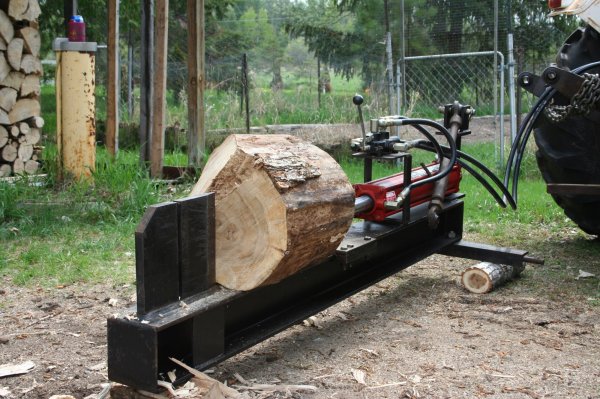

Is anyone using a tractor mounted log splitter? Maybe I've been looking at my splitter issue from the wrong angle. Get a tractor that the grands kids can ride on and I can clear snow AND split wood with.

I agree. PTO pump is the way to go for these. What's nice is you can lover it virtually to the ground to roll a big round onto; no lifting!
Most of the time I used mine it was on the ground to get the big ones on but the cycle time is slow as was mentioned. That's why I bought a normal splitter. Easier to move around too.
They have their place but if you are doing a fair amount of wood, do yourself a favor and make a fold down leg to split at waist level. That way you can roll in the big ones and work up the rest at a non back killing level. With no stand on the end they bounce and chatter sometimes when you throw a round on. As others have said, unless you have a larger, newer farm tractor with a large gpm pump, it just adds to the ache. I personally would put them at the bottom of the wish list and we still own one that even Dad avoids anymore.

It really depends on the tractor and the splitter. If you had a tractor with 10 GPM flow and Splitfire 3203 you would get good cylce times. You can get them with a PTO pump but then you can get a nice standalone for the same cost.

If you're having slow cycle times, you're doing something wrong. Run her at least halfthrottle, if not more. I run my splitter off either tractor or skidloader hydraulics and I really have to hustle to keep up. I've only been around a couple self-powered splitters, mine will absolutely run circles around them. Sure, you burn more fuel, but if that's your main concern, might as well use a sledge and wedge.

LOTS of different size gpm pumps on tractors and the older tractors were pretty low especially when dealing with single outputs. Some of our newer ones had adjustable gpm that we'd turn up when using a homemade 6 inch. Still slow and I think it was 32GPM. Using a 990 Case/David Brown, it was SUPER slow. Buddy had an 8 inch he hooked up to an excavator but lord knows what that thing was. It was just plain scary strong. I'm runing a 28gpm pump on a 5 inch and it works great for me. Your normal home owner small tractors do not need high GPM pumps so they just aren't there. I think that is what most here are referring to.
I was going to bring this up. My little 24hp tractor I think has like an 8gpm pump. The math means my tractor would be slow.
