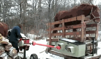

    This one is probably the quietest, but it's only 1hp
