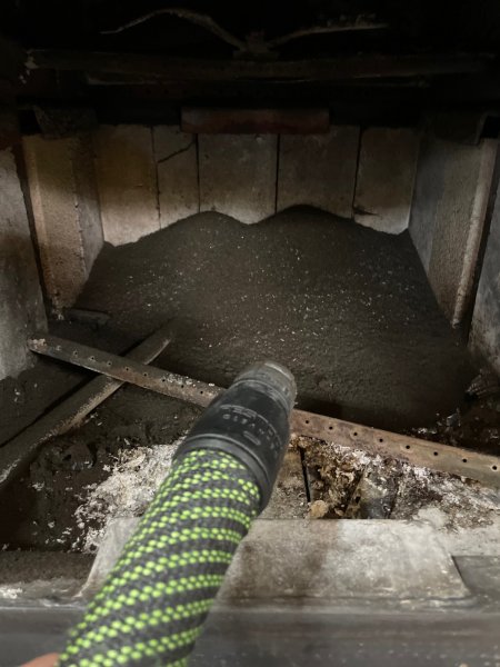

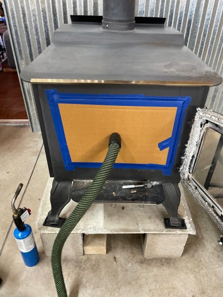

    Since I moved into this house, I haven't swept the chimney. After two years of burning Lodgepole and Ponderosa mostly (guessing 14 cords), I bought a chimney sweeping kit on Amazon and did the job. Like some of you, I'm pretty careful when it comes to dust. Removed the baffles and ceramic boards from the stove. Then cut cardboard slightly larger than the opening. Sealed it with sticky painters tape, this brand is highly tacky (DUCK brand I believe). Cut a hole with a Forstner bit and plugged in my Festool HEPA vacuum (perks of the woodworking business). Put on my dust respirator, turned on the vacuum to create a draft and climbed the roof.
    This Vogelzang Ponderosa stove is in a barndominium and has a 25 foot length of pipe I'm cleaning. Cleaned from the top down. About 2 gallons of chimney dust/creosote collected and vacuumed. Next up, new door seal on the stove and new chimney cap. Our wind and frequent hail has taken a toll on the current one.

    First, I will apologize for being a "numbers" person and for any math errors in my calculation, BUT... Your numbers indicate your average soot level is 0.08 inches at cleaning while the maximum recommended thickness is 0.12" (1/8"). 0.08" is an even spread across the entire chimney but my soot is thicker in the cooler spots and so you are most likely over specification on soot in spots. "Glaze" is easier to ignite but even black soot can cause a chimney fire. The numbers for better or worse:
    2 gallons is 462 cubic inches
    462/25'/12"/6" diameter (guess)/3.14 (pi) = 0.082"

    Fascinating data! I had never thought about it in those terms. I can definitely say it looked like an 1/8" thickness towards the top. Now that I have the tools, I'll take precaution and chimney sweep each year. For those that think Pine is terrible, I think these results show it isn't anything crazy. The 2 gallons was an estimate (not factual data).
    Thank you for taking the time to calculate

    Lodgepole exclusivley, Colo and Wy, 80-100% flyash. Zack323 , do you burn mostly low fires?

    Could you explain more? I'm unfamiliar with flyash. I burn to heat my home all winter. Last year was 100% my wood. The first year I got 6 cords from a supplier in town and don't think it was dry like it should have been. I have a temp gauge 3 feet up the stove pipe and most times I'm in the 500-600 range. Curious on your advice. Is that too much soot?

    Sorry Zack, I'm no expert, but have burned a long time, other's here have excellent advice like Ronaldo and Mag Craft might chime in, and see iowahiker's take on numbers. Flyash is light fluffy ash, mine is white and black, light grey. The darker flakes/chunks in your picture could be from wood that is not seasoned enough or all low slow burns. I can't say on the volume but I'd make changes if that was my sweep.
