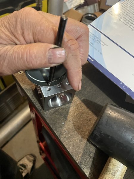

    Well I tried and had to give us finding an EZ Lube grease cap to fit my Old Harbor Freight Trailer frame wheel hub!! I really don’t think they make them anymore! I saw many that said either 1.98 or 1.99 and even though some said they would fit, they just slipped right out! A little frustrating to say the least!!
    So I purchased a set that said 1.99” from e-trailer.com that say TRP on the rubber part which are the exact same as what Autozone sells and luckily Harbor Freight sells a Doming Block & Punch set. I selected the #3 and banged out 4 domes and Bingo, I could Bang the cap on to stay!!!

    I have some bearing buddies but they would not stay on either. They are nice but too thick to do any doming on. After doing the doming the Dexter caps fit nice and tight and seem fine. I am losing some grease out the back seals so I probably need some new ones. I am not sure the grease in there is high temp like the red and tacky so I want to replace it all. I also want to get a cover to keep the rain off which also may help the bearings last longer.
    That doming kit worked great!
