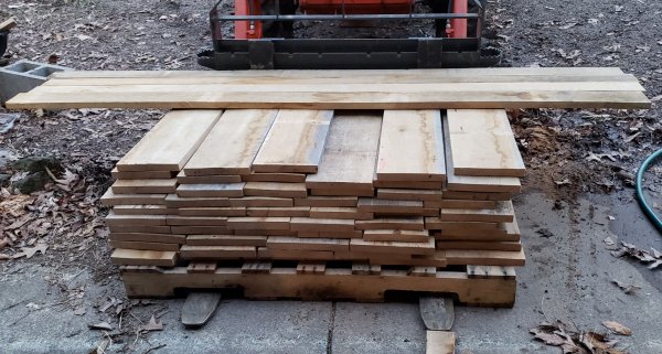

    I've been working on making siding for our new barn. We had a 20 x 20 steel carport with no sides. I'm planning to build a 36" high, board and batten wall for the sides out of a bunch of random-width, air-dried oak I had milled a couple years ago. The upper 5' will be barn curtain. Since my "boards" will be about 7.5" wide, I will need almost 60 of them for just the two sides. Likewise, I will need the same number of 2.5" battens. Here's the "boards" cut to length. I still need to rip them to consistent width. The four, 8' pieces will be some of the horizontal piece into which the b&b will be screwed. For those of you following my other posts, you may have noticed that I have WAY too many things going on right now. Don't worry, the sheep will be starting to lamb at the end of the month. EEEEEKKKK! :hair:

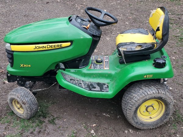

    And yet another "project." This one is unplanned. I knew my idler pulleys were wearing out on my lawn tractor for a few months now but I had been putting that off. I finally got around to it the other day. Once those were replaced - a horrible, needlessly fussy operation - I could hear the noise coming from my PTO clutch. That's shot too, so now I'm replacing that and the drive belt. Clutch replacement is simple as one bolt. Replacing the drive belt was obscenely ridiculous, involving taking apart the front tie rods, and numerous other little sub assemblies. As it stands now, I have everything but the clutch replaced. I'll have to wait a couple more days for that to arrive in the mail. Aftermarket was literally half the price of the OEM at the dealership. By the end of the week, it should be wrapped up. And by the way, I busted several bits of plastic on the hood just taking if off. Whatever JD says, I prefer metal.
    Here's the broken bits:
    And here's the hillbilly lift system

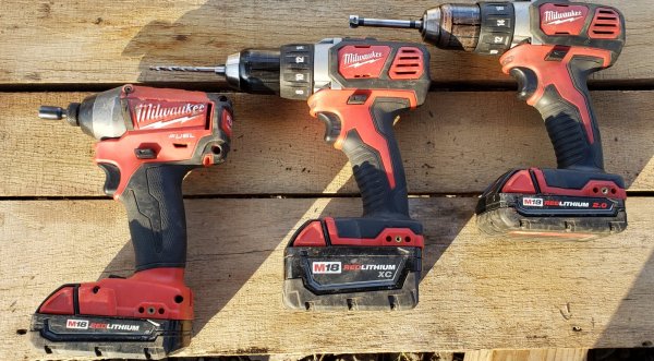

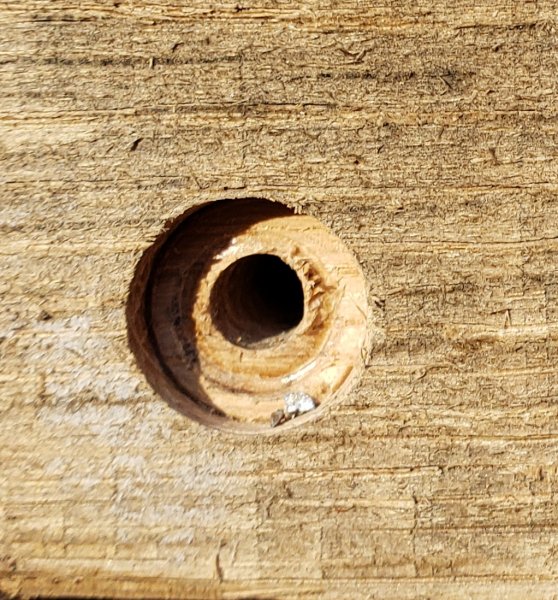

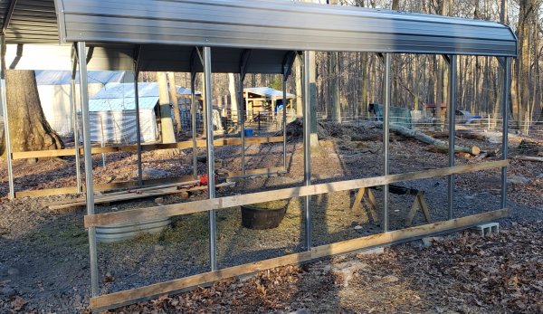

    Made a little progress today putting up the horizontal boards to attach the boards and battens to. I used some 4/4 random width white oak and hex head sheet metal screws. It was convenient to have two drills and a driver to use for forestner bit (countersink), twist bit (pilot) and driver, without having to continually change bits.

    Good job on the canopy! I am Like you on the drills! I have a mess of 4.5" grinders all set up with cup brush, stringer brush, grinder wheel, cutting wheel etc.. Sure beats changing them out all the time!

    Actually, I only have 2 drills because I dropped the first one and messed up the chuck. It works like 90% of the time. So, I got another new one and use the old one for projects like this.

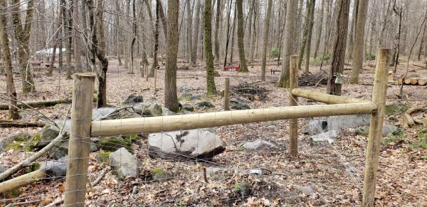

    Finally got some more fencing hung. This project has been proceeding in fits and starts for several months now, including clearing the trees, driving the posts, setting up the bracing, etc. It still needs to be tacked up and I have another ~200 ft to hang.

    P.S. Please excuse the wonky posts. As you can see, our ground is very rocky/bouldery, and sometimes you just have to take what you can get.

    It is very tough to work with rocky ground when putting in fences - and it doesn't help when you have to take down trees and fight with their extensive root systems either. But I happen to think that the less than traditional look you have going works very well in that setting :thumbs:
