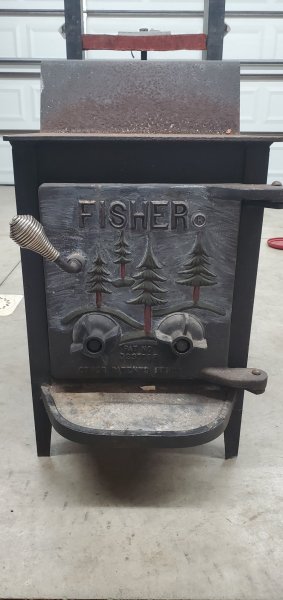

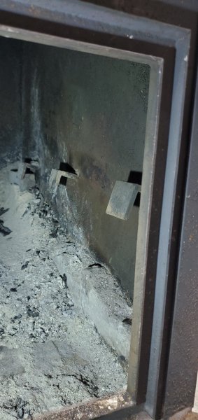

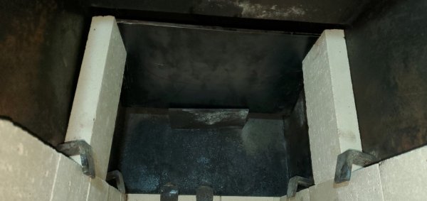

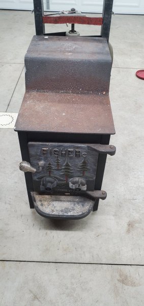

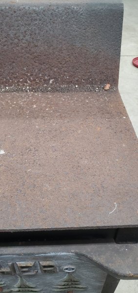

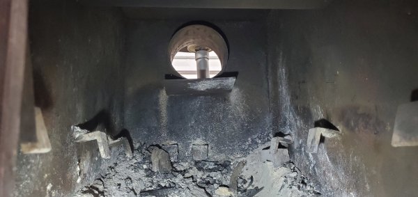

    Just picked it up tonight. $223 off Facebook marketplace. Not the best condition but definitely safe and good for my use! One front leg is a bit twisted and the top is heavily pitted. Otherwise it looks really good. Judging by the tight door pins and no louver slop, I don't think it's been used much. No cracks or warping.
    I will try and fix the leg but I'm no pro with metal working.
    Bricks need replaced - I would have done them anyway. Are the brick holders supposed to be angled like that?
    Definitely want to install a baffle. One thing at a time.
    Someone was an artist!

    The angles are straight in mine.

    I've read that these can bend like this from excessive heat. I think someone ran mine with the tops of the bricks broken off but besides the warped angle irons, the unit is solid. The top is severely rust pitted but oh well - for me it's ment to be used not look good.

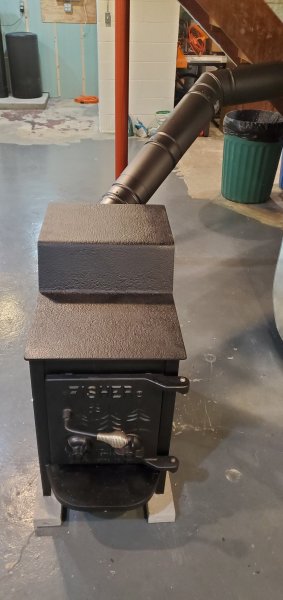

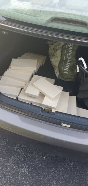

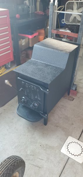

    Have some free time on my hands so I've been doing some tinkering. Got the unit stripped down, cleaned up, and painted. I got somewhat of a deal on firebrick yesterday at tractor supply - 50 cents off because they had them advertised for the wrong price. Suckers are 4$ each these days!! I got 30 but think I will be returning some.
    I've done tons of reading - may have read every Momma/Papa bear thread ever. Mine only had the lower row of bricks from the factory so I guess I'll keep it that way. I really like the idea of the upper row, but welding those brackets on would be a real pain. Unless WeldrDave suggests otherwise?

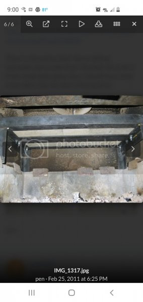

    Definitely need to build a baffle - either going to do Coaly's simple 5/16 plate, or build a angle iron frame that holds the fire bricks. Leaning towards the angle iron frame for a few reasons:
    -I already have the materials
    -I feel like fire bricks would deflect/hold heat better (although it may not even matter)
    -It seems like a sturdier option (although Coaly says it's fine - I believe him but I also know I tend to jam/throw logs in)
    May get out the old welder today or tomorrow and have some fun.

    Photos: the frame design is a screenshot I pulled from another site. Thinking of building something like this.

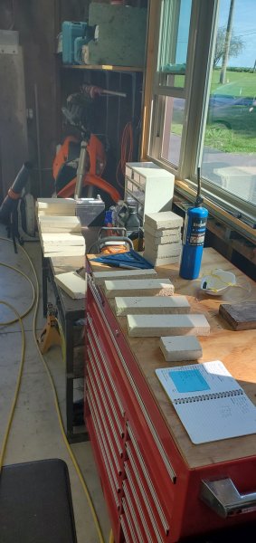

    Trying to decide if cutting these fire bricks warrants getting out the wet saw... or if the angle grinder with diamond blade is sufficient.
    Wet saw will cut nicer and will be easier to make the cuts but I'd a PITA to dig out and clean up when I'm done....
    Angle grinder won't make as nice or as square of a cut and makes tons of dust. Simple to get out and put away though.
    Decisions decisions
  6. brenndatomu
    20,555
    128,086
    I use the angle grinder with diamond blade...use a black marker to mark your cuts, take your time to eyeball it straight n true, they come out just fine that way for me. I set up out in the yard so the dust mess is minimized...still need to wear a N95 mask while cutting though.

    Bricks cut. Now to test fit

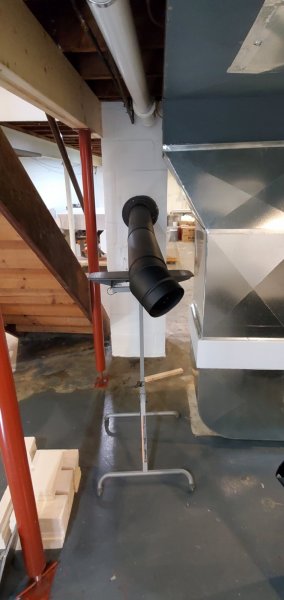

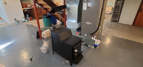

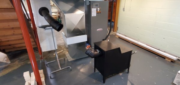

    In the midst of the chimney mockup. The chimney stack I'm connecting to needs swept before I do my final hookup but just realized it's an oval shape so I think I need a different shaped brush....
    Otherwise, all is good. Furnace is 24" away from stove but it's all metal except the condensate line and AC refrigerate lines which I plan to install metal shield to protect.
    Currently in experimental/mockup stage so things could change. But so far, this is looking like the direction I'm headed.
    Also have my pile of firebrick ready to install and my 3/8" baffle plate.
    In no real hurry, but hope to do test fire it while weather is still good so I can keep the windows open to vent out the paint smoke.
    Any pointers, thoughts, or suggestions?
    Thanks!

    Looks pretty good to me...

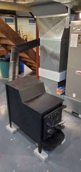

    So my chimney stack I’m connecting to is a 4x7 oval stainless liner. If my calculations are correct, that is the same internal area as a 6” pipe. Couldn’t find a brush for that size so I got another 6” poly brush and I’m going to cut it down to fit.
    Once chimney is cleaned, I can start final chimney pipe install. I want to put some supports hanging from the ceiling so I got some plumbers galvanized strapping. Doesn’t need to look pretty as it’s in a utility area of my house but I’ll be as neat as I can with it.
    Almost ready for test fire.
    I have a feeling this chimney is going to draft extremely well. I’ve got 4’ of horizontal pipe, one 90, and 2 45’s but I’m connecting to an internal chimney that is approx. 22’ tall.
  18. Born2Burn
    Born2Burn
    Jun 20, 2017
    325
    1,723
    Youngstown, OH
    How'd I do?
    Test burn tomorrow to burn the paint off and fume the house out with the windows open.
    Broke one of my leg bricks so I'll have to replace that but I think I'm pretty well set.
    I was planning to hang the pipe with pipe straps but it is super sturdy now that it's screwed together. Obviously I can't hang my weight off it, but it would take a lot of muscle to as much as move it.
    Lit a piece of cardboard inside to test the natural draft and sure enough, it pulled right up and out the stack.
    All double wall pipe from Menards.
    Thanks to all of the wonderful online support, I think we'll be warm and safe for years to come.
