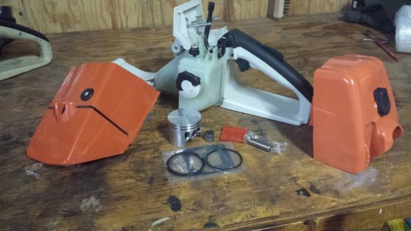

    So I bought a chicom big bore kit to play with. The kit says for 372xp, did not pay attention to details or pictures.
    It arrived a few weeks ago. Had some the today and went to mess with it. The intake port on the kit is tiny lime half the size of the OE one.
    It clearly won't work as is bit wondering about the differences in the 372xo over the years? The one I have is a 2011 model, if u can tell from the tag, which I assume is the date?
    My saws intake is almost 2x the size of the kits.
    Can I just swap intake boots ?
    I an clearly not sending this thing back to china. And it will just go back up for sale on ebay if I can't fabricate it to work. To ebay to look for parts I go as I await the experts here.
    Picture of the kit I got.

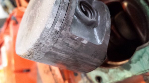

    Well after 3 tanks I burned up the piston on the chicom set up. The cylinder is fine though. I had it running a little lean at first then had it running slightly rich. Trying to dial it in right, it started screaming at half throttle. Shut it down and it was real hot. No air leaks found in my boot set up so Im not sure what caused it yet.

    Nothing has jumped out as what the cause was yet. I have a MS260 pro and Husky 350 that are going to be due for rebuild soon too. Leaning away from the cheaper chicom crap after this piston, but not ruling out operator error yet... 20140321_103401.jpg

    WOW that is nasty!!! That looks like more than an air leak!!! More like straight gassed and over revved!! Not saying thats what you did but what it looks like!!

    That is a pretty extreme seizure. I would definitely do a vacuum/pressure test if your gonna rebuild that saw or any others.
    There is a reason on why the saw seized in the 1st place. You need to fix that problem, before you fix the piston and cyl.

    Not to sound like a broken record, but I would hunt for the failure or cause of the meltdown that happened in the first place. Air leaks/fuel restrictions?
    I just did a failure analysis on a gents 036. Found a hairline crack on the fuel line right by the carb. Seals and carb checked out fine.

    As bad as it looks, it didn't seize, the cylinder is fine just a few very minor marks. Those will clean up easily. I will be sure to find the problem before I throw another piston in it.
    It wasn't straight gassed. It did over rev off the charts when this happened so I'm leaning towards air leak. I did just replace the intake set up. I was checking everything I just worked on every 5 mins. I'm not sure of the best way to check for air leaks?
