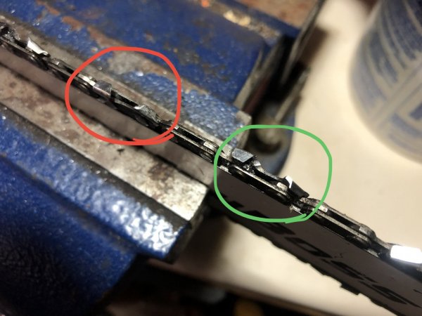

    IMG_8306.jpeg When you sharpen past or to the line at the end of the cutting tooth.

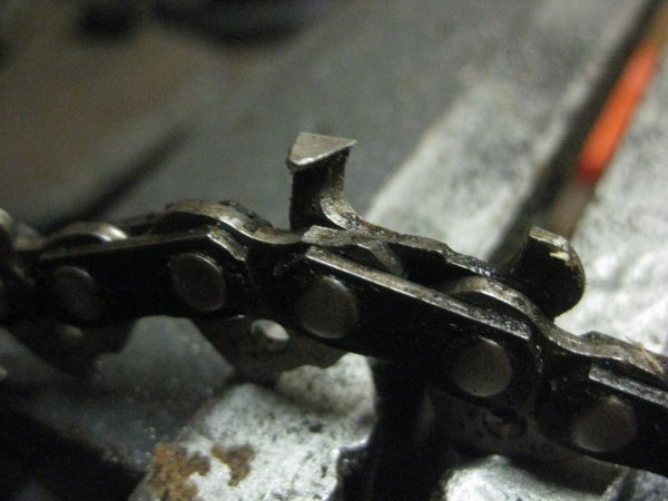

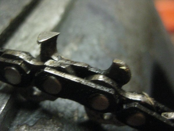

    I sharpen down to little nubs and use that for cutting a stump, roots etc...a sacrificial chain. Sometimes as the teeth get filed smaller they will break off easier while cutting harder woods.
    16" chain with maybe a sharpening or two left. I hand file only. IMG_3904.JPG IMG_3901.JPG

    Excellent stump chain right there.
