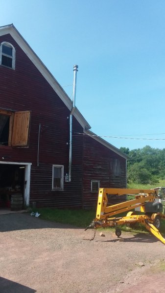

    I started this install at my dad's farm in the catskills back in April or may. Put a used quadrafire in his workshop and vented it through & up. I only had time to get it up to the eve then, but finished it in a few hours today. Thankfully he rented a lift which made things way easier.The cap was slightly used, so didn't bother taking the unnecessary flashing off. Took about 6 hours to do mostly by myself.

    Looks good :handshake:... Yeap, I'm sure that lift really help the installation process...

    Looks like you are well above code!!

    Thanks!
    Thanks, and it sure did!
    Yes..... followed national fire code. My dad just needs to close off that room in there so he has a warmer shop section.

    Nice install and good to prepare now for winter.:yes:
    I like that he has power to the barn too.

    Right tool for the job!
    I was looking at the picture before I read the post and wondered how you did that.
    Looks great

    I'll bet that lift will come in handy in the future too.

    It's a rental, so we fixed some upper windows in the barn as well.
